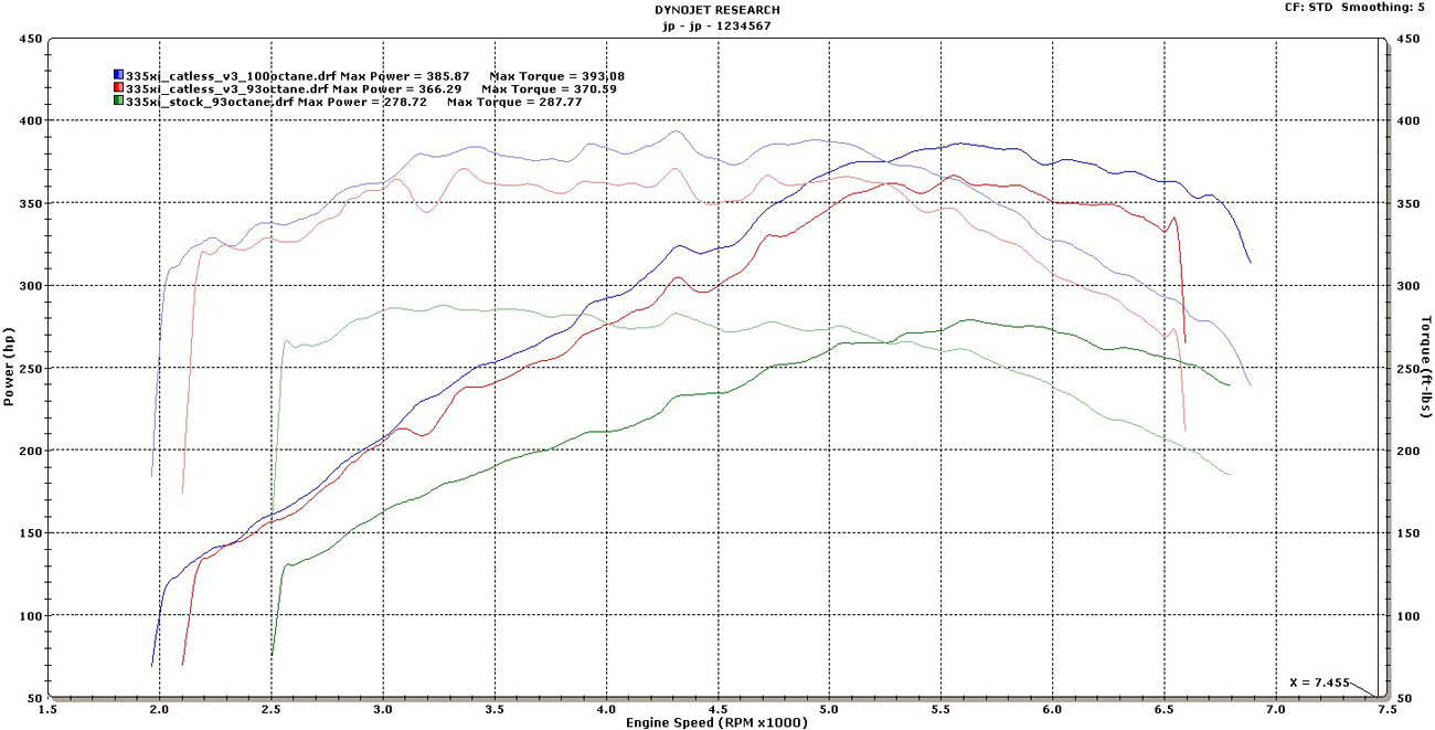

I heard the same thing which makes me wonder where this 100AWHP is really at? .5BAR increase with some tune changes might do it but definately not across the powerband unless the extra timing is helping that much?
Well, its not a true 100AWHP as people dynoing there stock 335/135s are getting about 290ish RWHP so obviously the car comes with more than 300base HP
Here is a stock 135i…
And let me see if i can quickly find a procede V3…
On that graph is…
335xi - Stock. 93 octane: 278whp / 287wtq
335xi - PROcede V3, dual cone intake, catless. 93 octane: 366whp / 370wtq
335xi - PROcede v3, dual cone intake, catless. ~99octane: 385whp / 393wtq

impressive power if it really can gain that much from just a tune…
