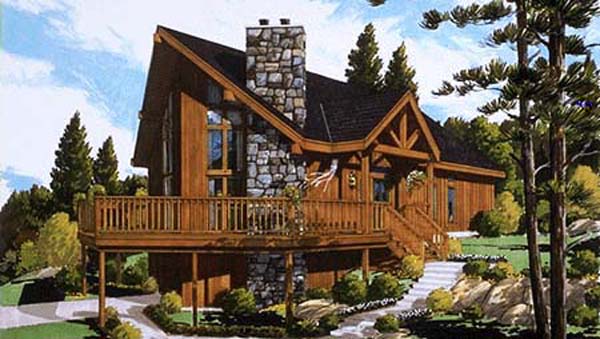

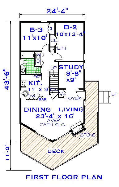

Actually I just talked with my mom and she would live with a design I found online. I thought they were nuts because it wasn’t very custom…
If they wanted to run with this, they would still need them to be stamped correct?
