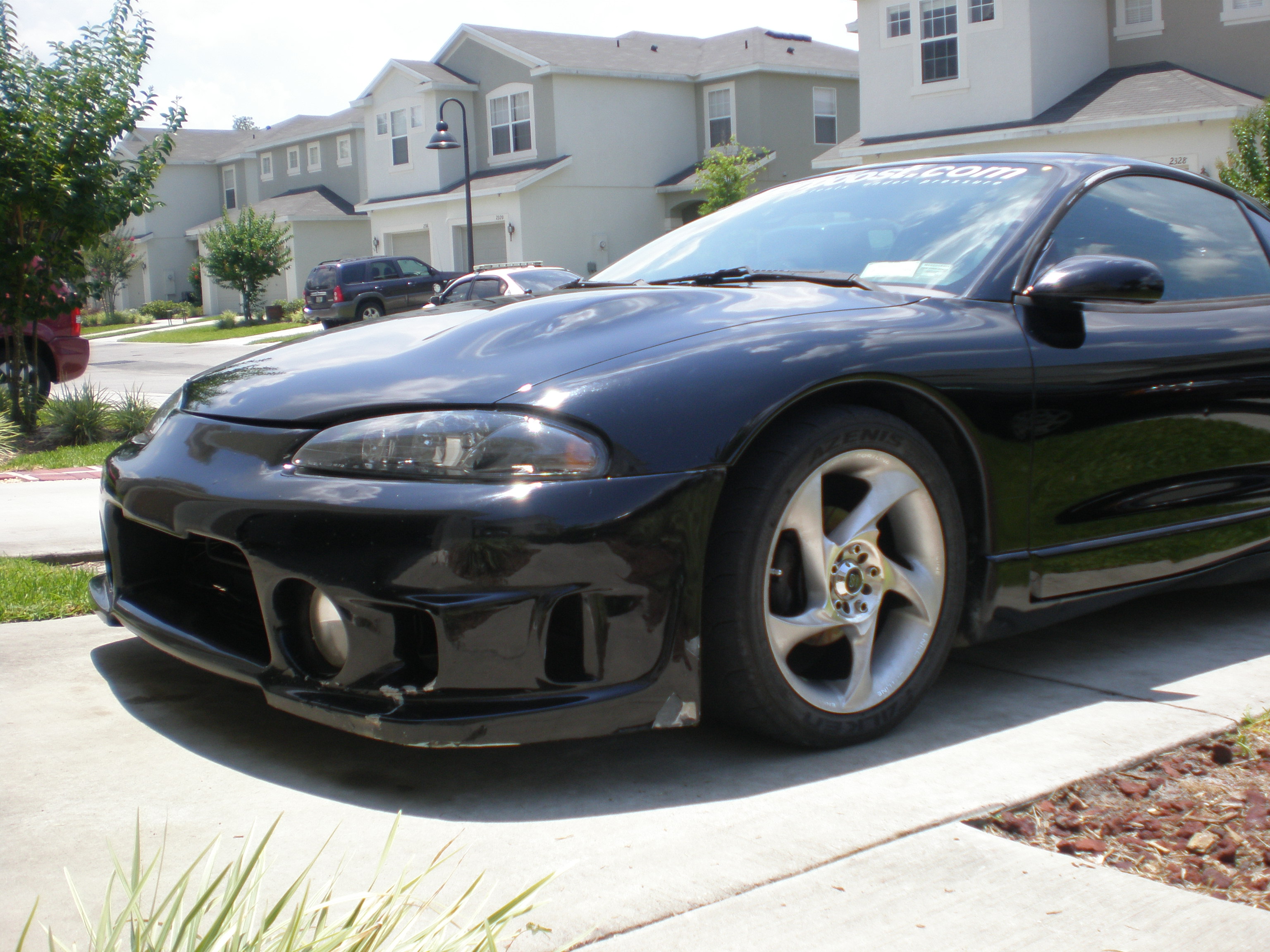

Here is the test fit with my SSRs, Clearance is good :):
