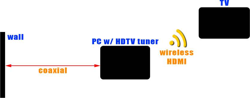

Question for you guys; How do I pipe all my premium / HD cable channels into my PC?
I’m not that big of a TV watcher, I use it mostly for movies. I have Time Warner digital with a cable box, but I don’t use the box (it’s just sitting unplugged somewhere.) I simply take the coaxial, plug it into my PC and watch TV with Media Center. Then I send the signal via wireless to a TV in another room. This works great, but I can’t get many premium / HD cable channels this way since the signal isn’t decoded. But is there some way with Time Warner to decode the channels without the box then pipe it into my PC? Is there some cable card box or something I can run in-line before my PC?

Maybe I’m thinking in the wrong terminology, but if cable card & tuning adapters are both free, what do I need a ceton for when I already have an HD tuner? Or is my internal HD tuner essentially useless then?
I need to see a wiring diagram, lol.
Here is my setup, very simple;
