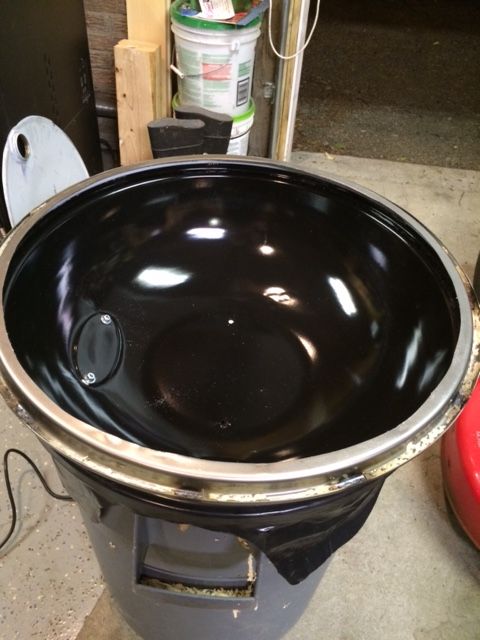

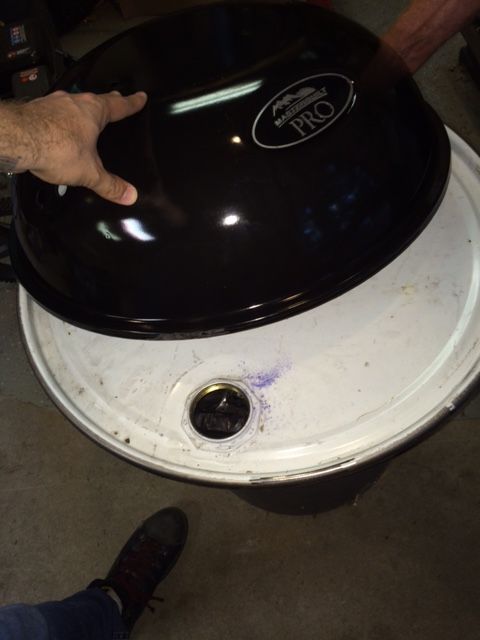

If you’re making a drum smoker, you can use the lid from pretty much any brand 22" kettle grill. I found a Masterbuilt on craigslist for like $20. I used an open head drum, so I had to modify the lid to make it fit by welding it to a spare drum lid and then cutting out the center. I have a weber that i use for grilling, and that lid is also a little too small to fit on the open head drum. I believe if you use a closed head drum and just cut it open, the lid will fit without modification.

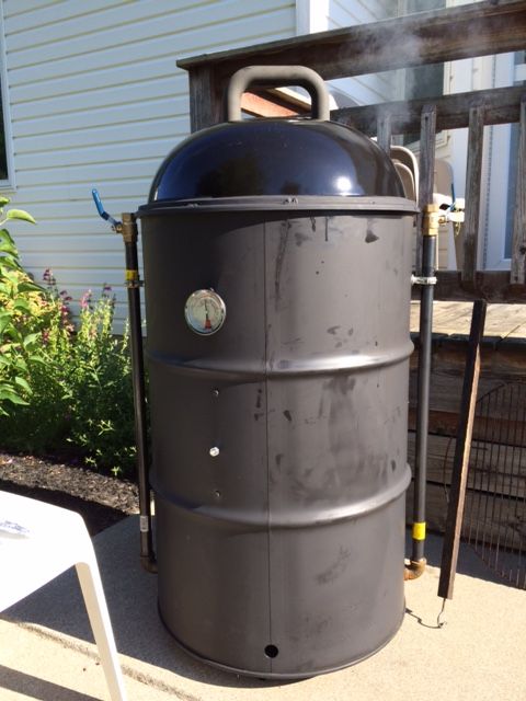

It works beautifully, btw.

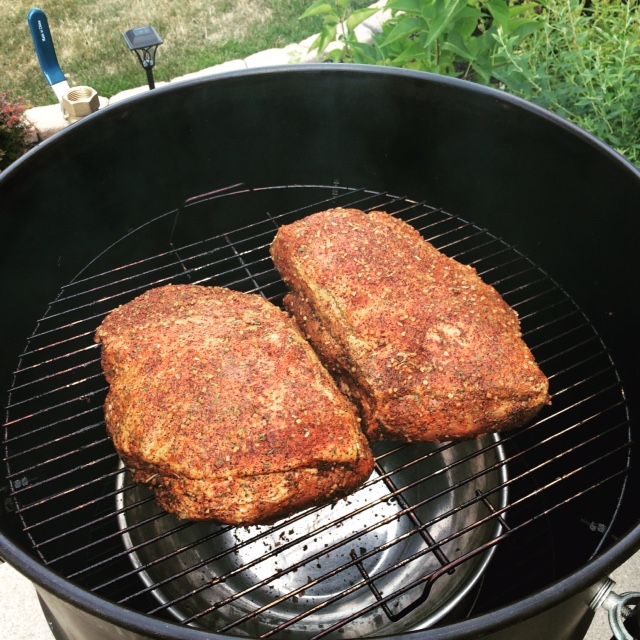

Oh, we’re smoking plenty in the drum, I’m trying to gain capacity and put in the second grate for ribs and chicken halves/quarters and legs so I can pile it full of meat.

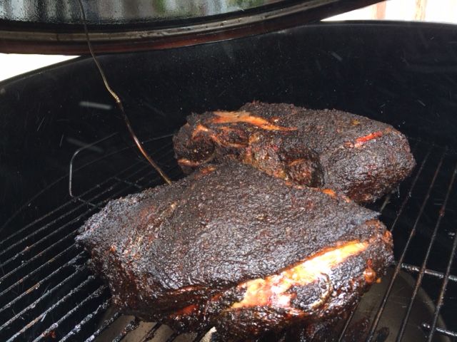

No PitIQ here. I thought about getting one initially but this thing holds temp amazingly well. I have to do a minor adjustment to the intake once every 3-4 hours. The PitIQ looks awesome though.
I built mine with 2 racks with the same intention, but only had the flat lid at the time. There was barely any clearance on the top shelf. The dome lid made a huge difference. I could do 8 pork shoulders in the 8lb/each range now, but I don’t have a small army around to feed lol.
