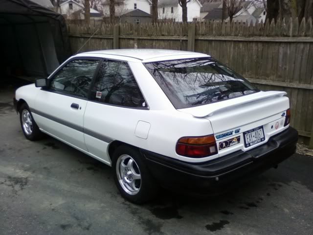

The new front bumper thanks to KellerSVT. I also started sanding down my rear bumper because I am planning on painting it white. The only problem is finding an white that is a bit off, which I think I have, I will find out tomorrow when I apply the first coat.
hey i almost tossed out the front gt spindles yesterday, you want them come and get them… i might even have good calipers to give ya, i just want them gone, and i have a gt front bumper ill let go cheap,i think i have 3 fronts now… let me know i need more room to strip another one…

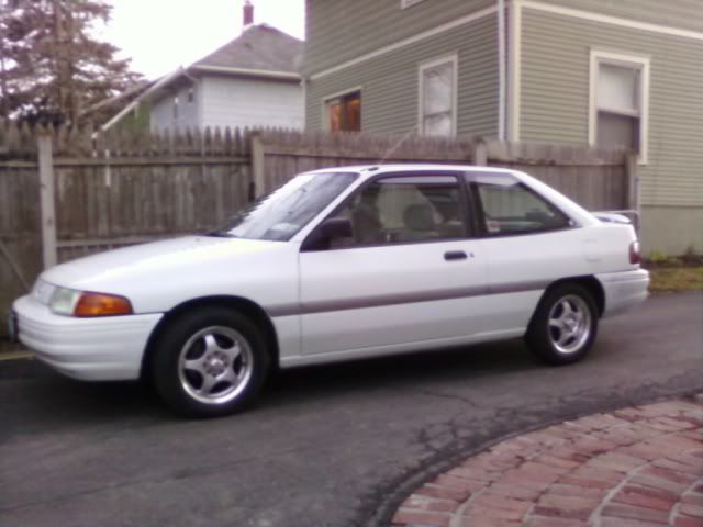

I was told by kellersvt that ZX2 struts would fit in my car with the exception of the center bolt on top of the strut. If I do this I could then lower the car maybe next year or depending on when i can get low profile tires for it. If I lower it now, the rear tires will rub on the fenders. So I will roll them up a bit inside the fender and see how everything falls into place.
This is what it looks like now, I sanded, put a light coat on and sanded again, took it off the car so it was easier and still needs a good deal of attention.
I think it will look a lot better once it is finished than the day I bought it or at least it better.

zx2 struts are escort struts, you want the zx2 s/r struts, they have a larger diameter shaft , are shorter, and different valving inside… and you cant just order them at a parts store…you will also need the front bearing plate, and mount…

if you really want to lower you car this yr, i have new st springs i had warrantied from them, and i can give you brand new oe style struts… and if you know the right people you can just keep using the lifetime warranties on it all… im goin s/r and maybe intrax springs when i do this one…
kellersvt - Alright we can do that, Im not gunna use it.
and with lowering it, probably not until next year when I can get low pros on it.
what is that an odd offset? i fit 205/50/15 on one of mine before, with the same springs…
