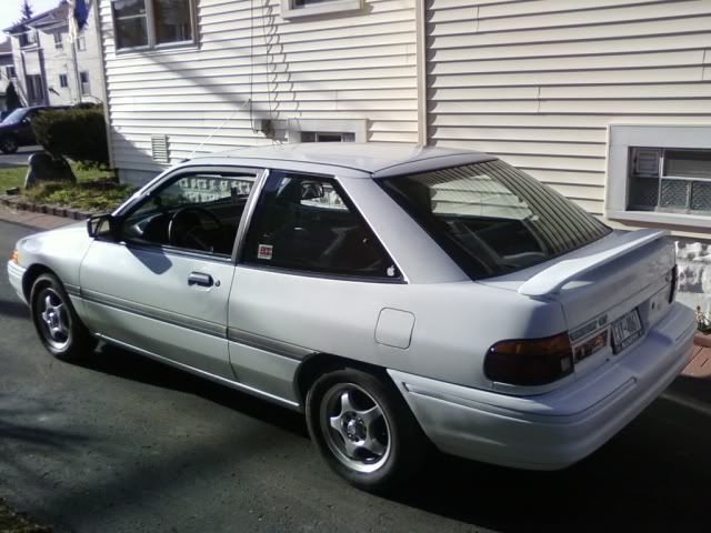

Got it looking good now…

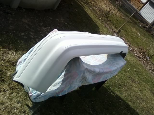

Bumper drying after paint and clear coat
Finished look

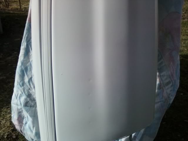

Why did you sand it again after the first coat? Why don’t you just lay another coat on after the first coat gets tacky. and are you spray painting this? How old are you ?
Why not? Its just like sanding after priming it. Gets rid of defects and makes the final coat look much nicer. If you just keep throwing paint on your going to end up with a shitty finish and you cant hide the problem areas. He is doing it right(other than dry sanding instead of wet sanding).
Nice little project…:tup:
I put a base coat on it it and dry sanded that, put another coat on, then dry sanded again. cleaned it up then wet sanded, then cleaned it up, then used an air hose to get everything off it. And then put about 4 or 5 light coats on it, then put a nice clear on it.
And that original post that you commented on was just some minor prep work I wanted to do.
This is it completed drying outdoors…
Close up…

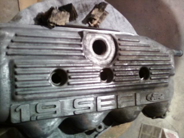

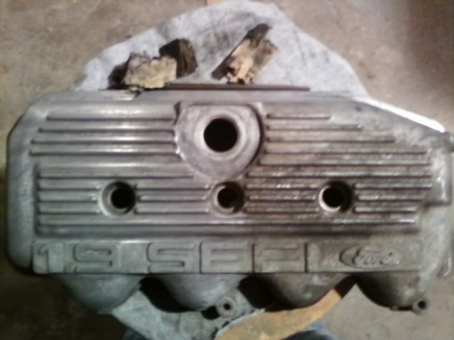

Also, thanks to kellersvt, he gave me a spare valve cover to clean up and use if needed, soooooo…
Started with this…
At this now, wanted to get a half done half the way it was look…
