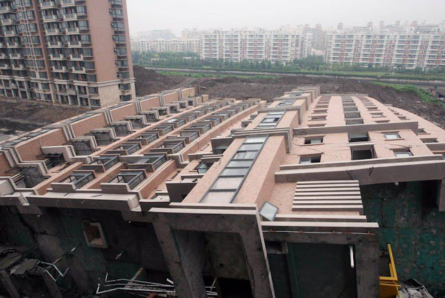

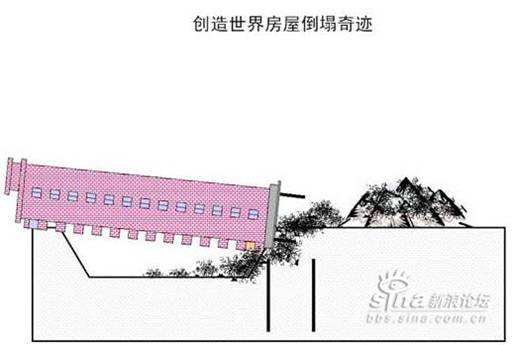

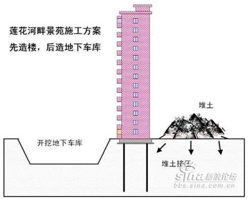

The other end of the spectrum…copied from an email I was forwarded
http://lh6.ggpht.com/_Gs9qi9HTIag/TOCJ0jfji9I/AAAAAAAAAps/fg83b0aQZ6U/s640/builing1.jpg

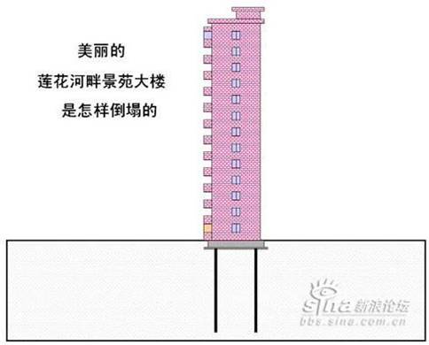

(1) An underground garage was being dug on the south side, to a depth of 4.6 meters
(2) The excavated dirt was being piled up on the north side, to a height of 10 meters
(3) The building experienced uneven lateral pressure from south and north
(4) This resulted in a lateral pressure of 3,000 tonnes, which was greater than what the pilings could tolerate.
Thus the building toppled over in the southerly direction.

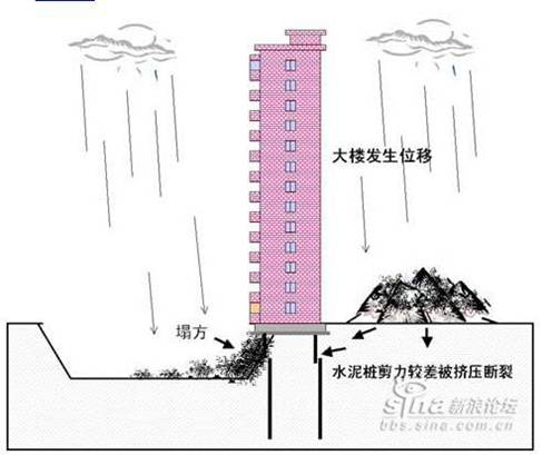

http://lh4.ggpht.com/_Gs9qi9HTIag/TOCJ00s4KvI/AAAAAAAAApw/6ikvYBYkWbE/s800/building2.jpg
First, the apartment building was constructed
http://lh5.ggpht.com/_Gs9qi9HTIag/TOCJ1ANMSaI/AAAAAAAAAp0/5Ig06DmEGdA/s800/building3.jpg

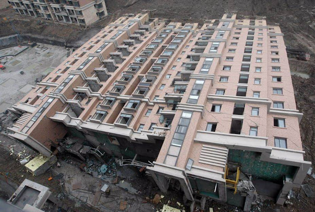

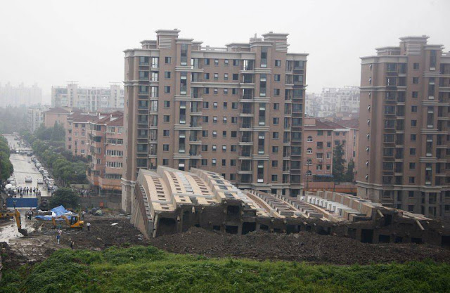

Then the plan called for an underground garage to be dug out.
The excavated soil was piled up on the other side of the building.
Heavy rains resulted in water seeping into the ground…
http://lh4.ggpht.com/_Gs9qi9HTIag/TOCJ1Tt-oEI/AAAAAAAAAp4/Sa-ojl6CVtk/s800/building4.jpg
The building began to shift and the concrete pilings were snapped
due to the uneven lateral pressures.
The building began to tilt.

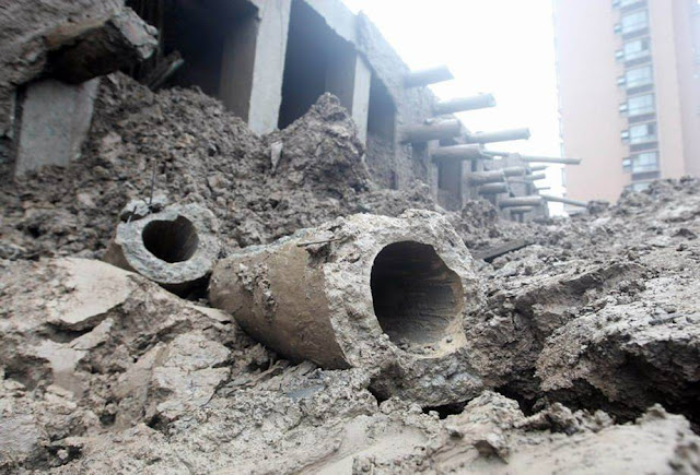

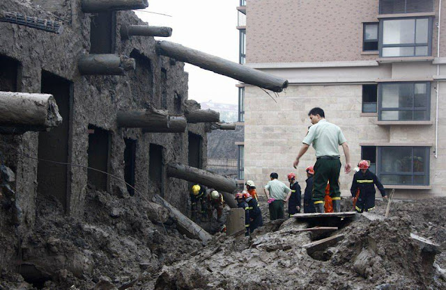

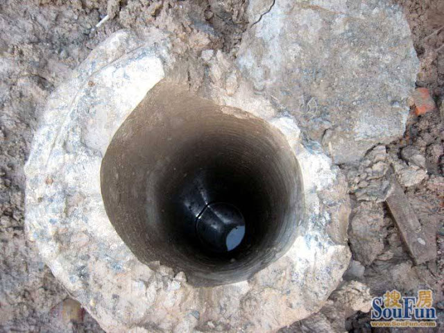

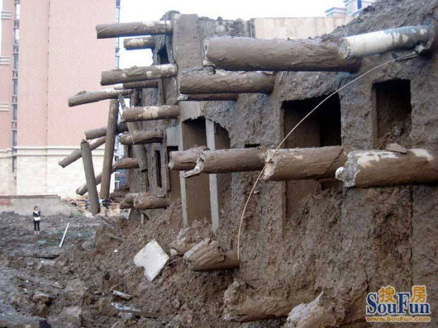

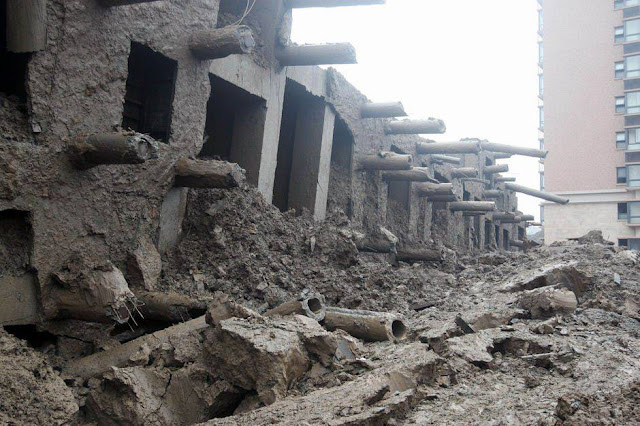

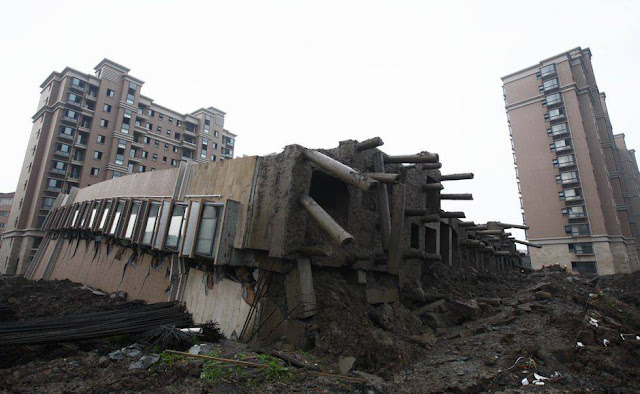

They built 13 stories on grade, with no basement, and tied it all down to hollow pilings with no rebar.
