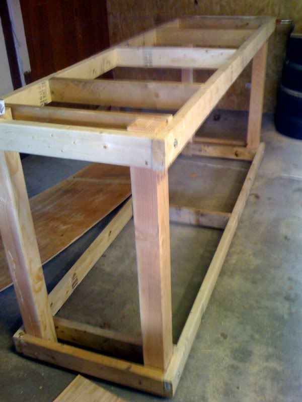

This is one of the ones I built. Can’t remember the exact sizes, but I do know the left over piece from the top fit in for the bottom shelf

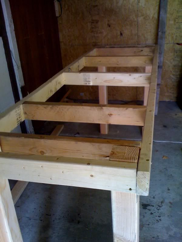

Doing this now … I’ll be taking pictures of the progress thus far in a bit. total cost so far is under 100 surface area is going to be 32" X 8’ and 3.5ft tall surface area. The surface area is this high for a few reasons. The most important is being able to work on the bench standing up and, the second is I got the old waiting room chair from hybrid, so it works perfect.

I used lag bolts instead of carriage bolts with washers, 4 around the top table frame and 4 around the bottom frame … let me upload the pictures now.

Here is the beginning after building the top table frame and lightly had the legs attached.
This is after adding the bottom frame to box it in and keep stored items off the ground. This will also be a great base for the drawers I plan on adding in the future.
The finished product for now. Still need to add the metal top to the right side. Also as I said before I plan on adding drawers to the right side.
If you look you can see where I put all the lag bolts. all four in front and then four in the back side. Between the lag bolts and the screws I used this this is burly as fuck. I still need to secure it to the wall but, it’s really not necessary.
