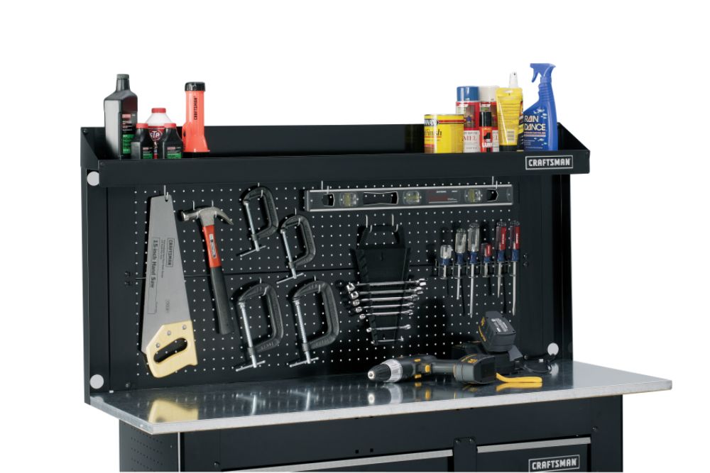

I picked up something like this from Sears a few years back for a stupid cheap price of like $225…has a pegboard backwall with top shelf and undermount light, few nice drawers and a large lower shelf. Stability is a bit iffy when hacking away on some metal in the vise.
