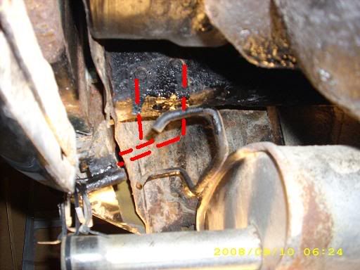

okay so my hanger bracket rusted out and i went to the dealership and they couldn’t find the part that I actually need.
would anybody know the part number to the red highlighted part in my picture??

I had the same problem a while ago. I managed to find the part number for it. It ended up being like $30-40 for a piece of stamped steel, so i said fuck it and just made one out of sheet metal.
If you want I can take a look and see if i can find the # again.
how’d you do that weld it or somehting??
and yes please to the part #
This happened to me too. Made the most annoying noise for the longest time. Then i just had it welded back up to the frame lol
85050J
I’m pretty positive thats the part number. More expensive then I thought, your looking at $50-60, lol.
I just got a piece of sheet metal, cut it to shape and bent it around the frame rail. Then bolted the hanger to it and wahhlahh.
