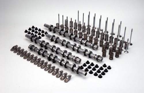

Parkway Performance (Adairsville, GA) is in the process of organizing a Group Purchase for the Ford Racing Performance Parts FR500 High Lift Camshaft Kit. A minimum of 5 firm commitments will be needed to start the GP. This price does not include shipping; you will be charged actual UPS shipping charges.
Pricing will be $1,250.00 plus freight
“You must use the complete FR500 valve train kit. The cams have the same as stock base circle (1.900) overall valve length is same as stock. The keeper grooves are relocated up to allow a taller spring. The kit followers are notched on the ends to clear the now higher retainers. The relocated / taller spring is necessary to prevent coil bind due to the .468’’ lift. Running that much lift on stock springs will coil bind and break your wallet!
Piston to Valve clearance will not be an issue.” This info is from Al Pappito, Boss330 Racing
Cam specs: lift 12mm, intake duration 258°, exhaust duration 254°, 109° center line.
