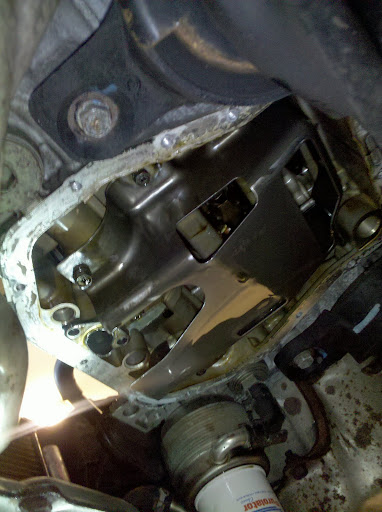

Pickup tube broke off where it connects at the block. Common problems on 2006 STi.
Since I bought the car like this, I didn’t know how long it ran without oil pressure. I decided to play it safe and rebuild the engine.

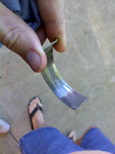

Rod bearing wasn’t destroyed or grooved. It was bronzed on the power side.
I took the engine to the machine shop and there is no damage. Stock clearances on the crank and pistons.

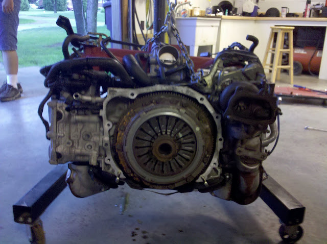

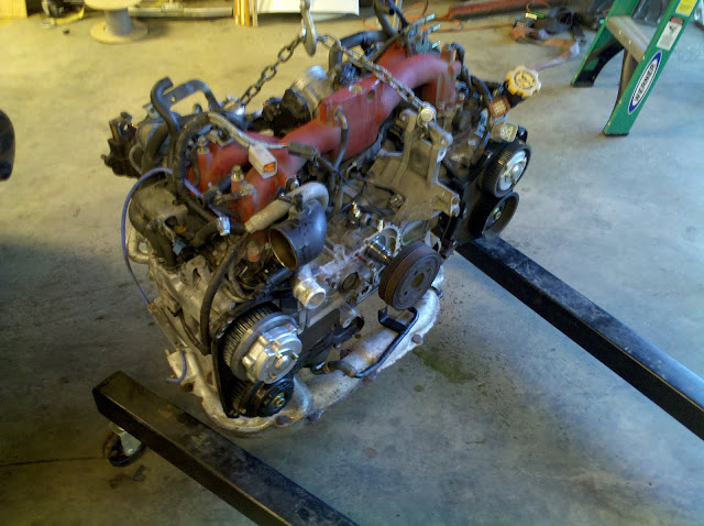

Somebody flattened my engine…

evos are not expensive anymore. you can probably pocket some cash. and evos are just new dsms, but overall alot better.
Jason drove his everyday with 4th gear somewhere inside the gearbox I swear it lasted like 30k or more like that until it finally pooped out
mod for mod, evos run circles around scoobs, but they still dont have that cool sound.

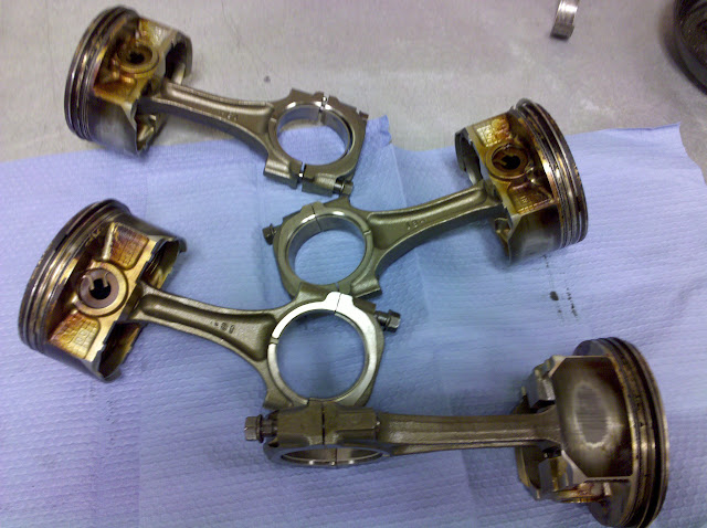

http://lh3.ggpht.com/_0SSSaBJJ7zY/TDSj-lRoYqI/AAAAAAAAAHw/yzbBVS94dCo/s640/2010-07-06%2019.50.59.jpg
Some blowby and skirt scuffing
I don’t know anything about Subaru’s What is the bore on that engine?
Just under 3.912" or something close. Don’t have the sheet in front of me. 1/8th of an inch from the bore of my 400 SBC! LOL
