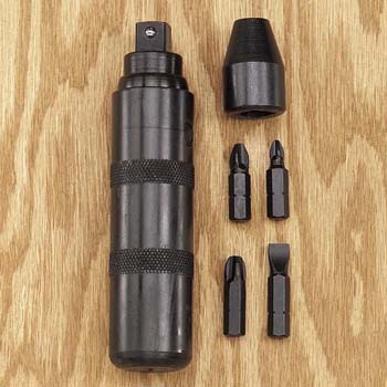

Those torx bolts that hold those doors on SUCK. Bring a sawzall if you have one. I ended up just cutting the lower hinge in half when I removed my junkyard doors, and removing what was left of it at home once I let it sit in PB for a while. Plus the angles you are working with aren’t the best. Different story if you need the hinges though. If you remove the fender of the Jeep you are taking the door from first, you can push the door open farther and that helps a bit. I destroyed at least one torx socket, Craftsman warranty FTW. Why they couldn’t use a regular hex bolt, I have no idea.
use an impact driver and bring spare bits
http://www.toolnet.co.za/images/47641.jpg
or ask them to take the doors and hinges off for you. might be worth the extra cost in this weather.
