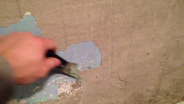

Main issue is the walls, which have a few layers on them. In many spots I can pick this off by hand, others require a scraper, and the rest seems to be holding up quite well. I’ve spent quite a bit of time picking at these walls with anticipation of sealing them in Drylok. However, I’m a bit concerned that I can’t get these walls stripped down to base concrete very easily. Are there tools or procedures that would work best here? Should I just pick as much as I can and then start Drylok? I’ve noticed that in areas that feel sturdy I can still pick at them enough to find efflorescence starting. This shit sucks, but I want to clean it up as best as possible. Thoughts??
Here’s a wall after about an hour of picking:
http://i84.photobucket.com/albums/k21/deener50/IMG_5034_zpsf01acabf.jpg
http://i84.photobucket.com/albums/k21/deener50/IMG_5037_zpsba64049b.jpg
Video below, click image to view:
http://i84.photobucket.com/albums/k21/deener50/th_IMG_5031_zps2wg6t3tu.mp4
If that is the worst of your water that you are not in bad shape. Drylok will probably never adhere and work on those walls without an incredible amount of time and energy, and even then it seems your water issue is stemming from the footer and not the walls.
I would hesitantly advise stopping picking at it and go ahead and glue and anchor up some 1.5" or 2" foam board as a vapor barrier. then build a wall in front of it.

My house in Cheektowaga was built about the same time, and had the same basement all issues. I did a heavy scrape/wire brush (with a mask just incase of lead paint); then used a concrete based sealer. I don’t remember the brand (I think it was a Quickrete product), but Luke_L and myself brushed on 3 5-gallon buckets of the stuff to cover the walls. It was a pain, and I sold the house immediately after; but while I was still in it, I didn’t have any more wall seepage.
If you want to finish it; go professional, no questions.
Thanks for the replies, guys. I don’t intend on staying in this house long enough to warrant the money to refinish the basement. I know the domino effect…walls, then ceiling, then adding a bathroom, then finishig the laundry…
This all stemmed from a realtor visit recently and the comment from the realtor that it would be incredibly beneficial for the walls and floors to be ‘cleaned up’. Now, I could prob just scrape what I can and slap some paint up and call it a day, hope that it holds between now and whenever the house sells.
Back to the domino effect… I have thought of framing the walls and drywall. I’m rather quick with that process, but I don’t want it to look too good to where everything else looks poopy. Hence the paint approach.
I’m also okay with allowing for seepage at the base of the walls. I realize the proper fix starts from outside the foundation, so letting a little water in every 5 years isn’t much of a concern. I’ll give these Frank guys a call, see what kind of numbers they throw at me.
@97FormulaWS-6 , did you see the video I linked? Did your scrape process look similar??
Didn’t watch the video, but did see the pictures and the pictures were almost identical to what my basement experience was.
