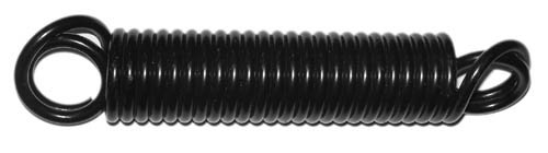

Maybe something like this would be an option, if you feel ok with drilling and putting lags into the basement wall (assuming the wall is safe to do that to)
Attach accelerometers to the system at multiple locations, record the data while using the bag to see what frequencies are being excited, order a custom tuned resilient mount to attentuate those frequencies.
Or if you want to do it the hard way :slight_smile: , maybe try a heavy spring to hang it and some isolation with rubber pads.
i looked for that, but not sure where to get them locally… suggestions?
I had something similar at my parents house. It will take the heavy shakes out but it still shakes.
i’d like a more detailed listing of it… so gay.
i have extra coilover springs sitting around… i should try and incorporate those somehow.
Give it a shot but I think that those will be too high of a spring rate and won’t dampen the shock. Try a truck snowplow shop. They have some medium duty springs that should work. Some of them already have rings on the ends of the spring. One other thing that may help would be to hard mount the end that attaches to the wall/ceiling. Much of the shock load that is jarring the house is when the bag ring jumps up then slams back back down on the mount ring.
