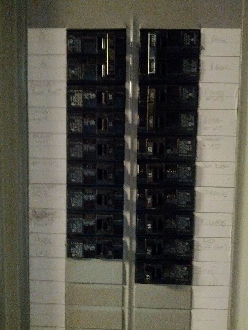

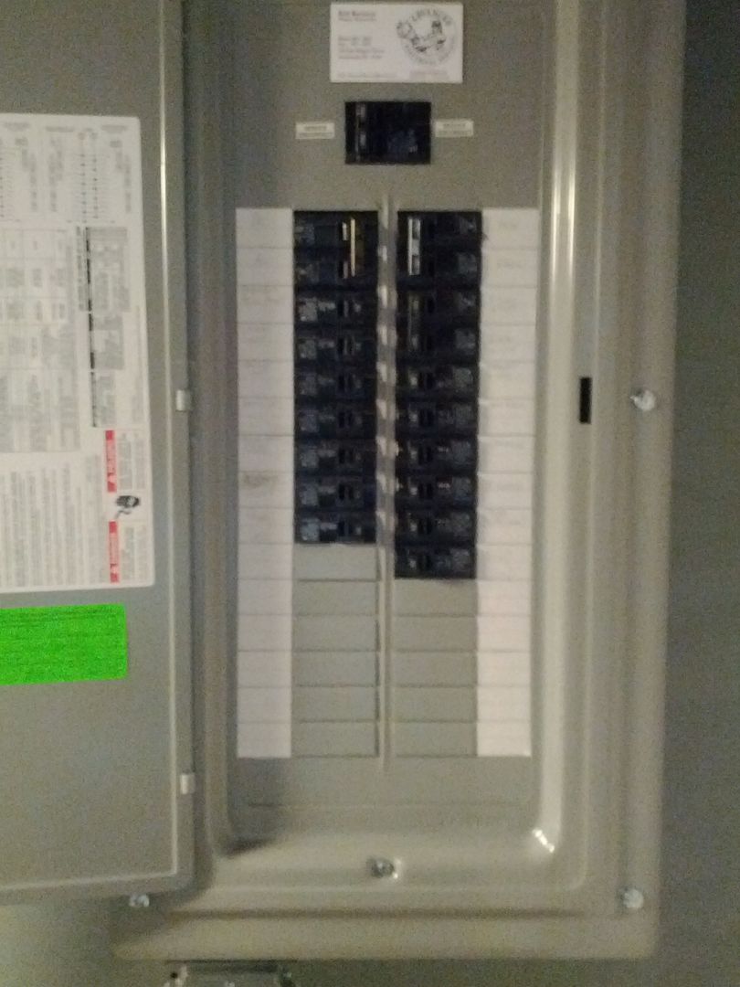

Final Walk-through on the house today, electrical looks a lot better now.
BEFORE:
AFTER:
Did you get the replacement of the electrical in the sales contract or did you do this?
Seller payed all costs for “Electrical Upgrade/Service”.
