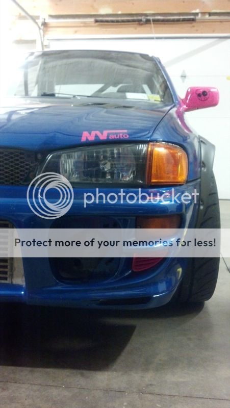

I have been talking with NV Auto (http://www.nvauto.ca/) across the border in Hamilton, ON. They are going to sponsor an alignment/corner balance. Headed up there next week to get that done and get her stickered up. The owner of NV is running pikes peak this year in his orange impreza.

I went up to NV Auto in Hamilton, ON on Thursday. After being detained at the border for 40 minutes (dont bring tools over the border, they get pissy), I arrived and the guys got to work. They adjusted the ride height, did an alignment (they have a hunter laser rack), and corner balanced the car. I had an excellent experience-- the guys took their time and got everything done right. With that said, I am not pleased with how much the car weighs. I’m just tipping 2900lbs with 3/4 tank of gas and no driver. I have no idea where this weight is, as I was anticipating being around 2750-2800.

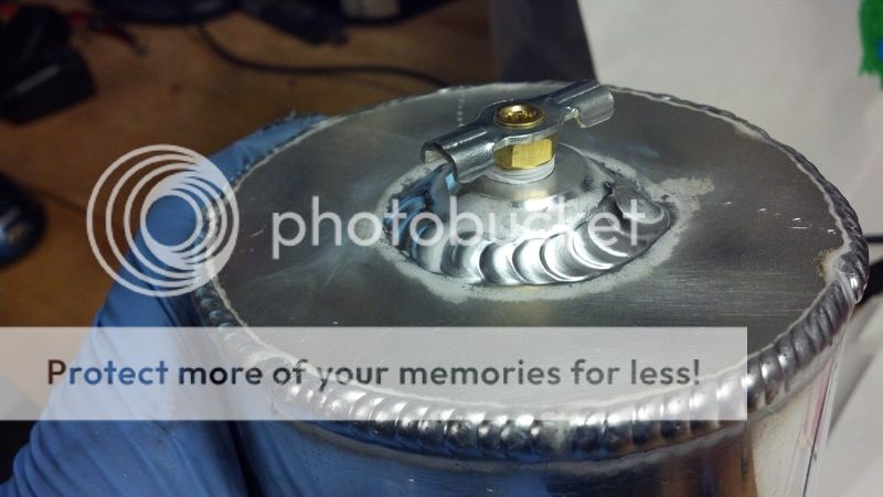

Fabricated a catch can. We didn’t put too much design thought into it, as this is a secondary unit. I am using the ixiz AOS, but Harvey had issues with venting that to the intake (oil was making its way into the intake on track), so instead we are venting it into a catch can.

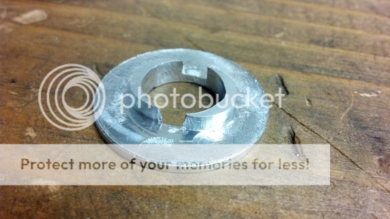

One of the major complaints with many coilover systems is that the manufacturers use a slotted hole in the rear to adjust camber rather than using camber plates. For a street car this isn’t a big issue, but on a track car, the bolt will move in the hole. One of the techs at NV Auto showed me a whiteline piece that locks the lateral link toe bolt, so I decided to copy the design and make them for the struts. This hole gives me 1.4* camber in the rear. Its definitely not the prettiest piece I have machined-- lots of re-cutting of chips.
Machined some wheel spacers. With 1.4* camber in the rear, the wheel weights hit the adjustment collar on the coilover.
