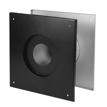

Thanks dude, yeah that’s exactly what I need, except that most of those boxes have a rain cap built in and dump the exhaust right away, like this: (this is actually identical to what I have on my gas fireplace wall penetration)
Whereas I need to get 12" away from the wall before I dump to meet code and to avoid melting the siding. I was thinking this
http://ecx.images-amazon.com/images/I/31yNhXcv3fL._SY355_.jpg
and just stubbing out the 4" pipe 1 foot to meet code.
I plan on tapping into that 3/4 right before the furnace drop and running 1/2 all the way to the heater. Based on the sizing chart I could get away with up to 50’ with 1/2 for that BTU, and I’m far less than that
Sounds good, yeah I had to of used 40ft or so of 1/2" for my 75k btu unit heater and my gas pressure is like 10"w.c. coming in, but never checked with appliances on, think she’s good, don’t use it much yet anyways.
