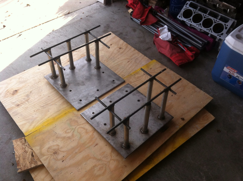

I spent a few hours on the MIG yesterday putting on the cross bracing (1/2" rod)
https://farm6.staticflickr.com/5826/21763084958_78b2f637ce_b.jpgimage by Norbert Ogiba, on Flickr
And after a Rustoleum Flat Black Enamel
https://farm6.staticflickr.com/5640/21950946725_d9d3af2725_b.jpgimage by Norbert Ogiba, on Flickr

supported it via jig on the rear set of holes. this was not too stable and it turns out the extra set of holes in the plate was a blessing in disguise.
https://farm1.staticflickr.com/605/22133905735_c5789204e8_b.jpgimage by Norbert Ogiba, on Flickr
I welded some nuts to the underside of the front most set of holes and suspended the plates evenly. much more stable!
https://farm1.staticflickr.com/723/21945713750_bb57896ceb_b.jpgimage by Norbert Ogiba, on Flickr
From there it was a ton of time with a wrench and level setting the heights equal, and angles to zero
