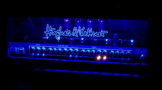

Like one of these tube amps?
http://i629.photobucket.com/albums/uu18/Rascolnikov/HK.jpg
