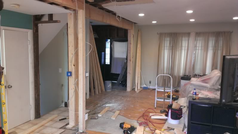

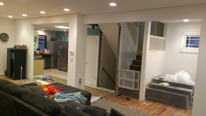

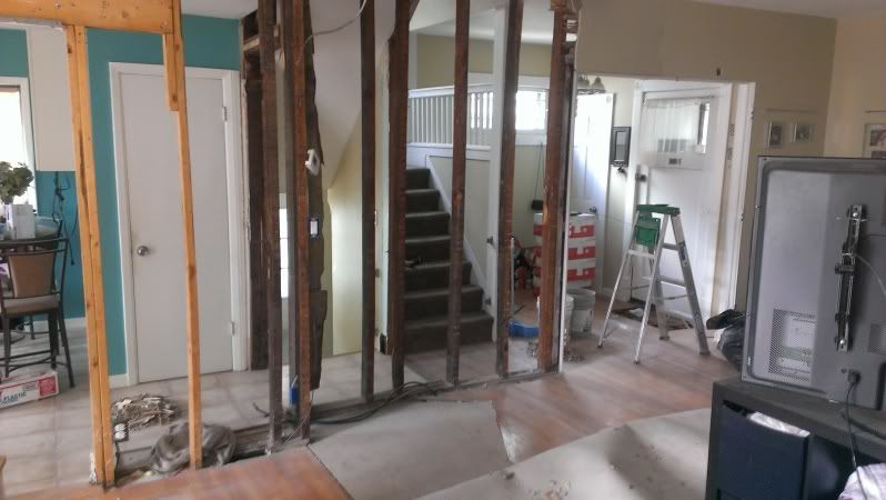

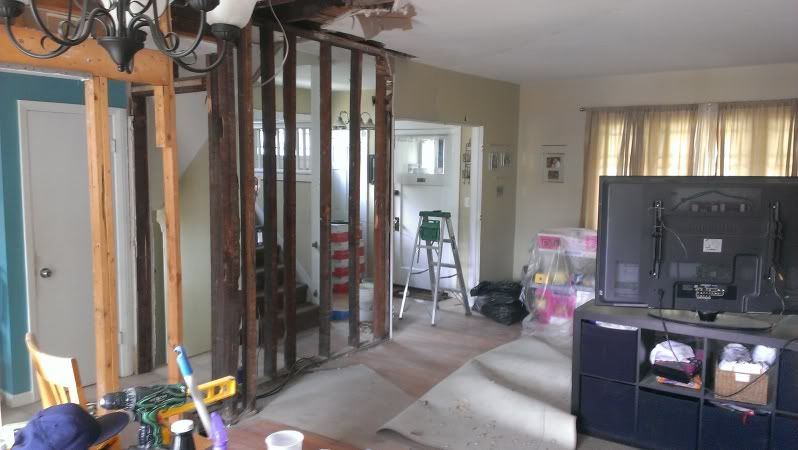

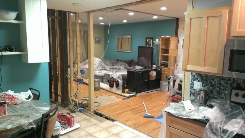

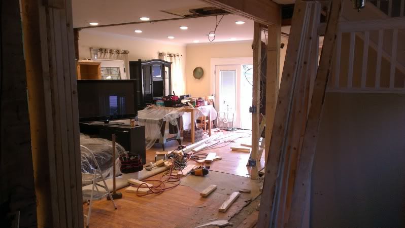

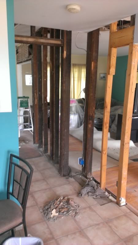

Been busy for the last month on my House. Tore some walls out.
I have been busy to say the least. Its hard when you live and remodel your home at the same time. I needed more space with two babys running around so I made some changes.
      • Updated - - -
      • Updated - - -

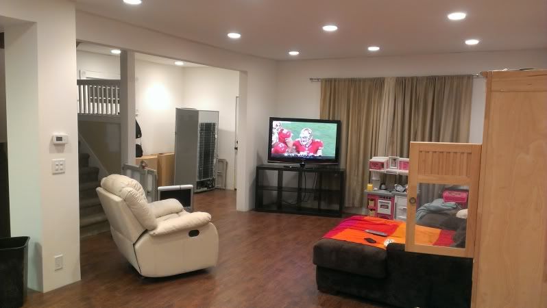

Almost done, need to do the rest of the crown, base, paint, cabinets, trim around stairs-doors, new furniture-curtains-entertainent stand etc. Did everything myself except lift the beam in place. Im fucking beat butt I have two vacations in planned to the Caribbean in the next three weeks to make up for it.

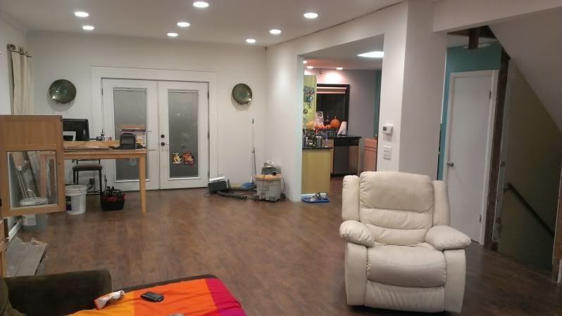

Open floor plan looks great. When is it time to upgrade the garage

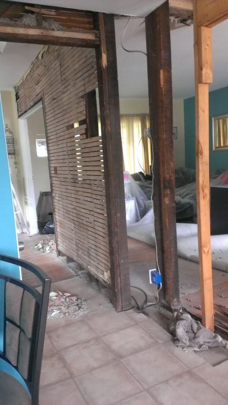

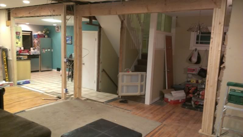

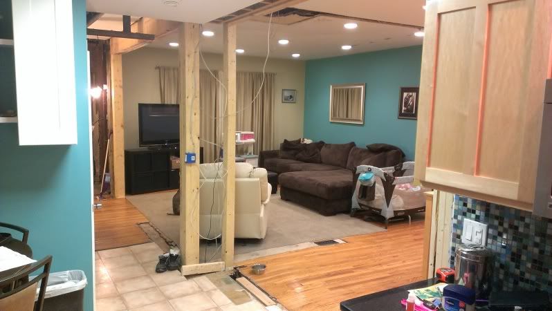

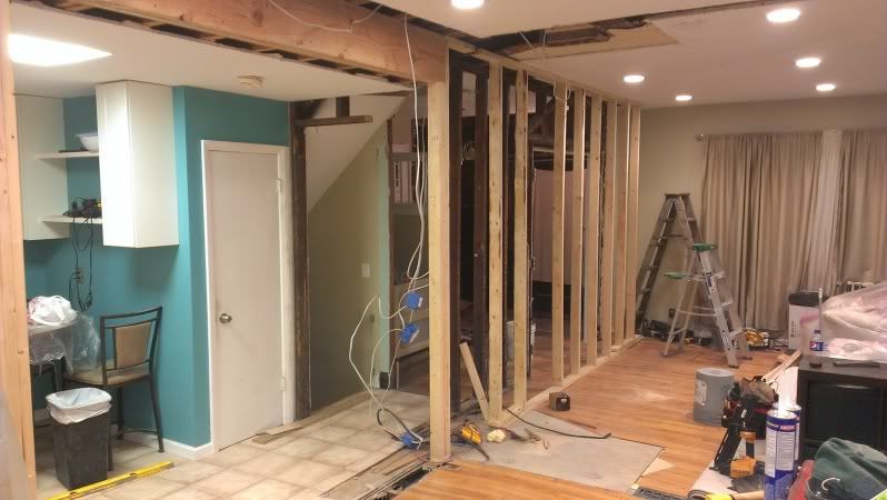

out of curiosity, What size LVL’s did you use and how big is the span there?

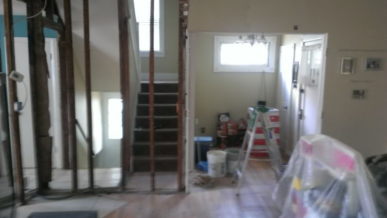

I am in the middle of something similar, just built my temp wall & another brace wall in the basement to support the ceiling joists so I can open up a load bearing wall. I need to get a engineer to spec out the header beam and support construction.

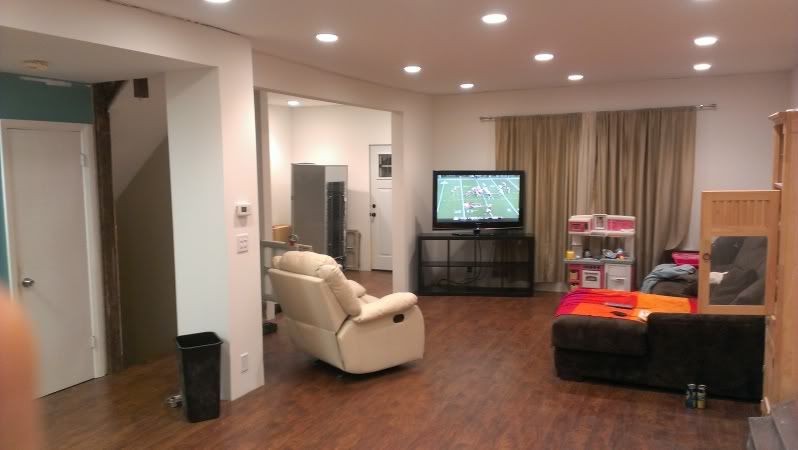

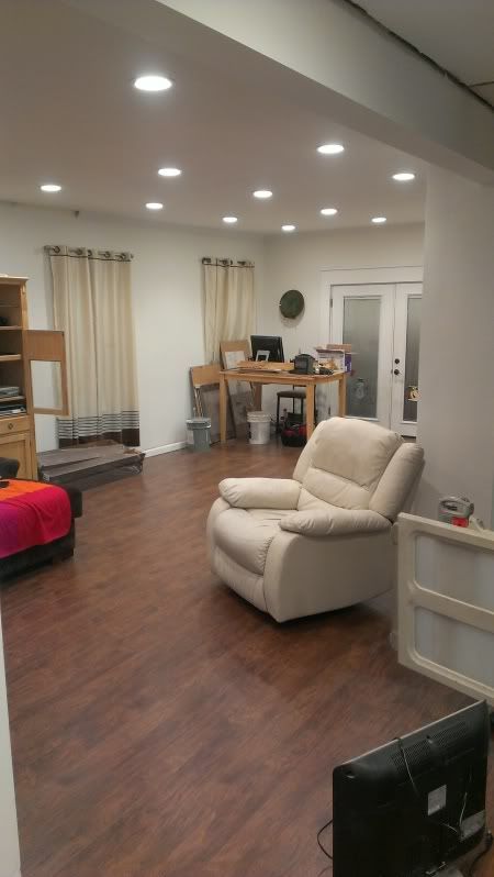

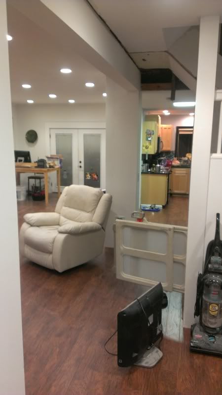

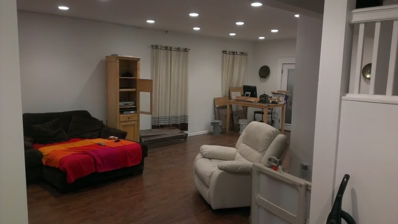

Info on the new hardwood (or laminate?) flooring?

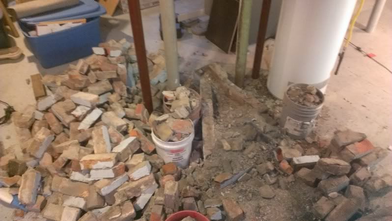

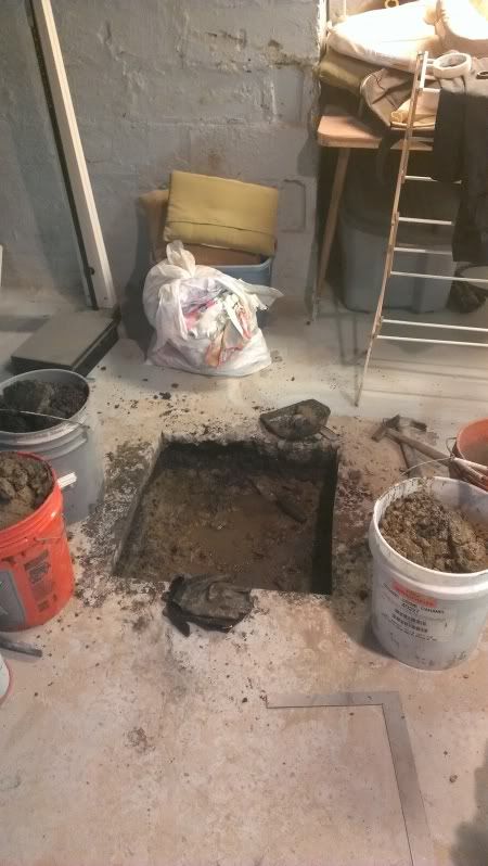

The two spans were a little over 9’ and just over 12’. The 9’ I used two 2x10 dimensional and the 12’ i used 3- 2x12 with 2x6 bearing posts. I had a engineer who is a friend of a friend come and tell me what I needed to do. The basement I had to dig out two 24"x24"x1’ footers with 5000psi concrete (10 bags each). I redid all the supports in the basement, the main support beam is off centered from the first floor old wall, hence the footers in the basement. It was a huge project to do myself. I lost almost 15lbs from stress and physical work.
The floors are from lowes, they are laminate. Allen+Roth, I didnt want hardwood because of the kids and dogs. It looks awesome, the pictures cant show how real it looks. Its hand scrapped toasted chestnut. I will put better pics up when I get back from vacation and everything is complete.Thanks guys.

Yeah I lifted about 12tons of garbage,bricks,etc over a 30 yard dumpster by myself.
