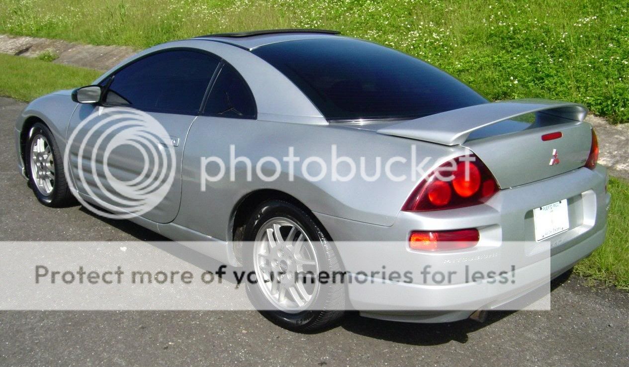

DIY: how to use all the wrong parts in your home brew turbo kit
the car is the 4g64 bythe way, its NOT the 3.0 v6 … which makes some of the parts that much farther of the mark … he didnt even manage to get the 255 walbro pump that fits the 3g’s tank !
this car is sooooooo going to make 160hp @ 7k rpm

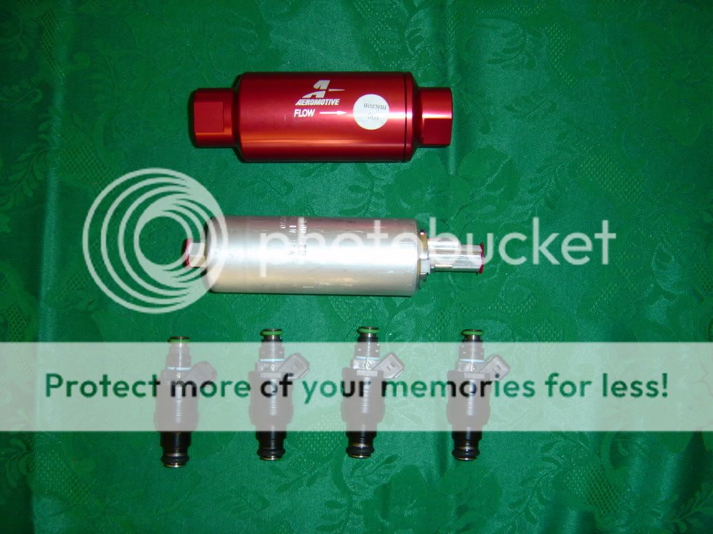

i also find the last smilie at the end of it ironic … the only edit i did to the post was to throw in the pump / filter / injectors picture that he posted later in the thread

wrong fuel pump
a fuel filter you dont need and will require extra mods to install

the only parts worth any money in that are the aeromotive and walbro parts, and maybe the obx bov … but im not firmiliar w/ obx stuff

It is an inline walbro. Can you not use an inline with that car?
no you cant, it would require making a custom pickup tube,
