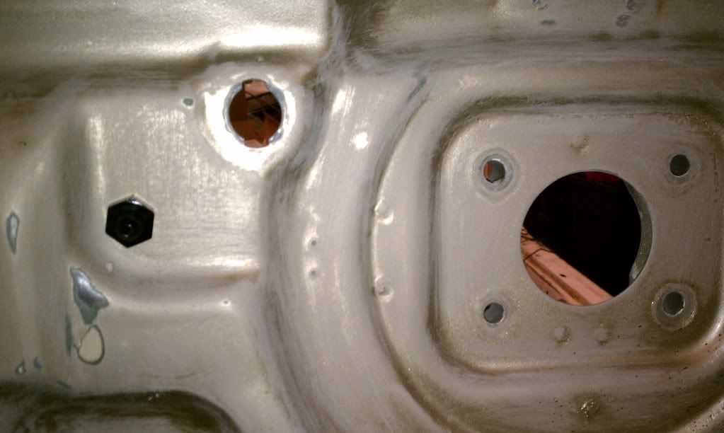

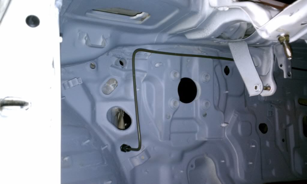

I started my brake line tuck, I needed to order more fittings which should be here today.

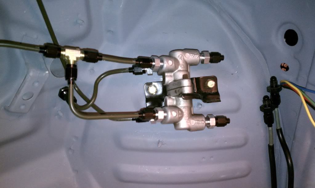

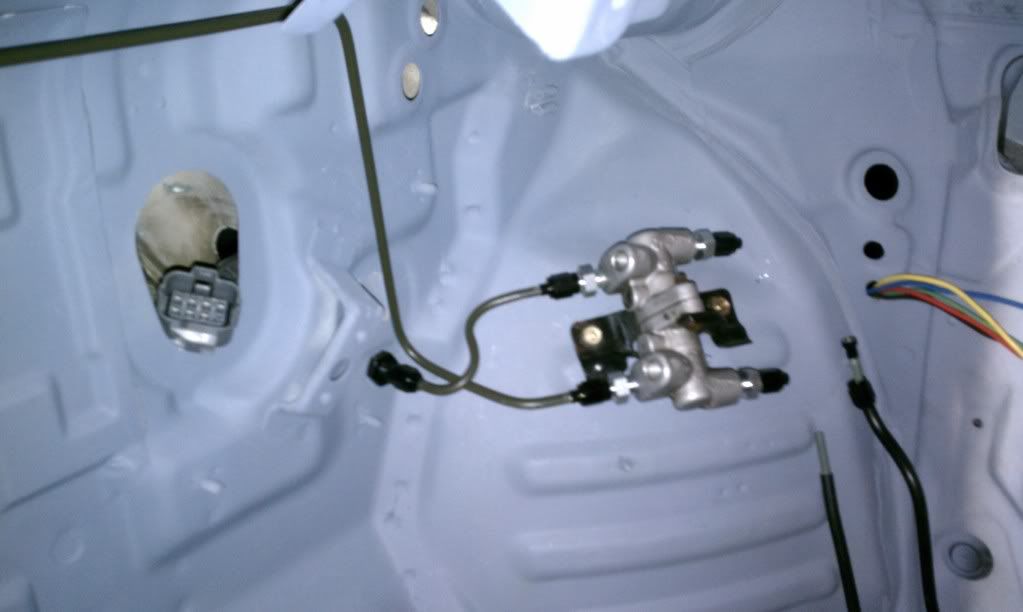

I put my prop valve on the inside right over the passenger fender wall. i put it there because if i ever had a problem I could just remove my glovebox and almost everything will be right there.
I ran my brakeline for the driverside over the pedel assembly where the stock fuel feed line goes.

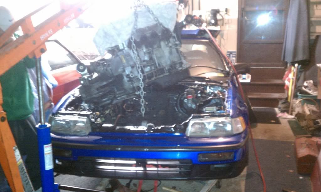

And last night my friend Nick and I helped removed our friend Mike’s B16 from his crx.

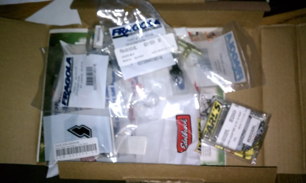

Well UPS guy just got here with the fittings I need HAHA
I’m still tired from pulling that motor even though it didn’t take long lol. YUM FITTINGS… those are mine right?

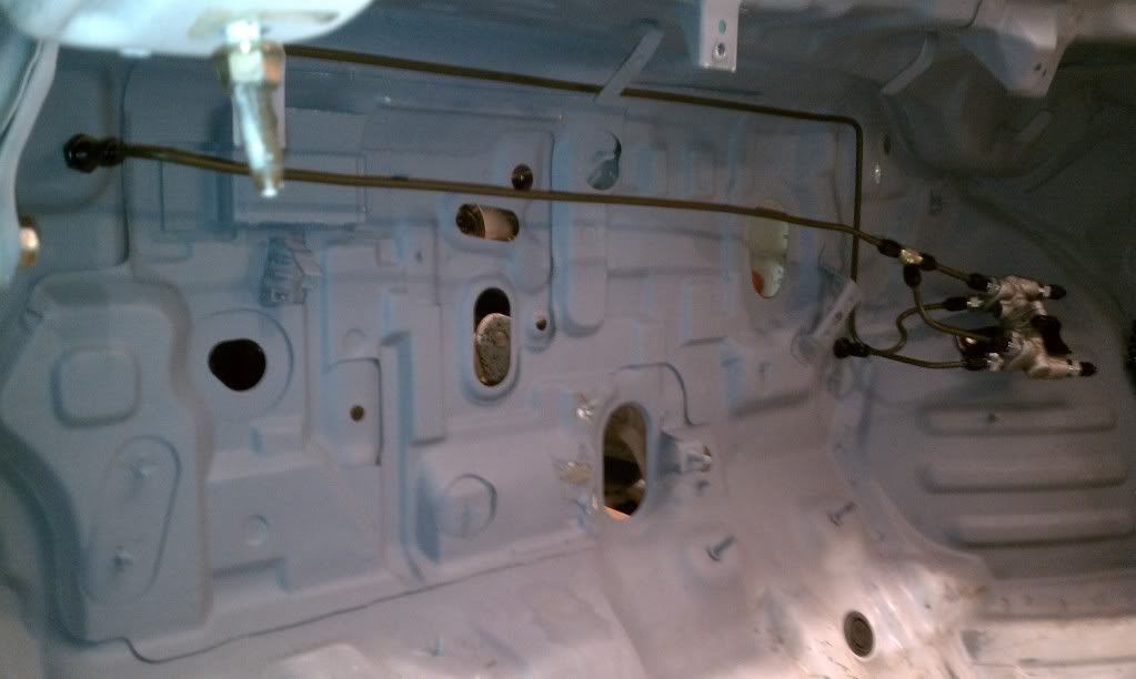

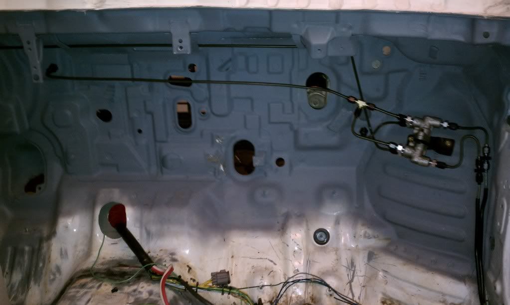

Finished the inside portion of the brake line tuck. Before anyone asks why I only have one line going to my firewall for the master cylinder, I am buying a chasebays brake booster delete kit and the wilwood master cylinder only has one line coming out of it.
