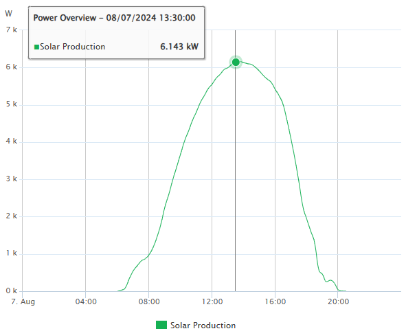

It’s crazy to think that at a time when our power grid is on the cusp of one of the largest demand increases ever (mandated electric cars, appliances, HVAC) that utility companies are being this short sighted. Here’s a crazy idea… instead of doing everything you can to discourage solar as a utility, incentivise it. The biggest complaint you hear from utilities about solar and 1 for 1 net metering is that solar pushes power into the grid, where they have no good way to store it, when their isn’t as high a demand. Solar’s peak output is 11am to 5pm as you can see from the attached graph of my production on a clear August day:
Peak demand however is generally 4pm to 9pm, as people arrive home and crank their ACs to cool their houses down, use more appliances etc. It’s a legitimate complaint from utilities that having to lower their production because of backfed solar then ramp their production up in the evening is not economically viable as more and more people optin to net metering. So figure out a billing system that HELPS put that battery in my house so you can store my excess power off your grid until that demand spikes and give me a bigger credit as you draw off my battery to cool my house and my 2 neighbors, or cool my house and charge my neighbor’s electric car overnight. As a utility you can now produce power at a more consistent and economical rate and use the stored excess power distributed across thousands of residential batteries as a reliable source for peak demands. Plus you’ve now locked people into your grid, basically as partners, instead of driving them off grid and losing them entirely.

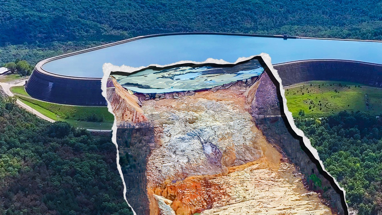

This was a timely post from my YouTube feed. Goes into what power companies do to address surge demands and at the end touches on the future use of batteries. If you’re an engineering nerd or like scientific dissection of engineering failures Grady is definitely worth a follow.
