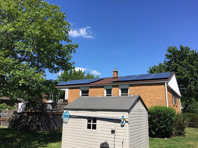

Congrats Man! My system has been in your state for 3 weeks now. We had it installed, then the inspector came out. Now, I’m waiting for a Final Acceptance from National Grid, which then gives them another 10 days to come swap out my meter to a Bi-Directional!
I am kind of bummed. These last few steps are taking FOREVER!
It’s been weeks now since I had that first kW. My meter in the basement with the system off now says 7 kW, it’s been so long! It’s been slowly getting power at 1W at a time per panel… ha
Soon though, you and I will be able to share data and crap
I just want to flip that switch in the basement SO BADLY!
I complained too soon! I got to flip my switch tonight!! Right after I posted my frustrations, National Grid showed up unannounced with my bidirectional NET Meter in hand. Final Acceptance, completed. It took five minutes for him to swap my meter and it was done.
Solar Liberty linked my account with SolarEdge and I’m off and running!!
The joy I had flipping the switch… even though it’s pretty much dark right now
8.96 kW … hopefully it’s sunny tomorrow!
