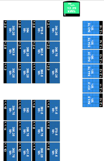

My roof is east/west with 24 panels in landscape on the west and 6 panels in portrait on the east. My 6 panels on the east did better today because the sun was out this morning.
All 28 of mine are facing directly south on a 20 degree tilt roof. I have a tree that blocks sun for 2 hours a day, but the losses I see there aren’t worth not having solar and/or taking the tree down. I also like my tree. I spent $350 to inject it this year, to save it from the stupid Emerald Ash Borer bugs. Jerks.
