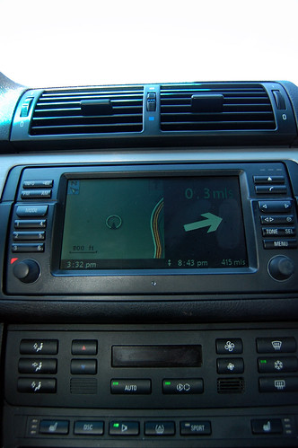

links to details on the Nav Upgrade? I have the identical Nav in the Range Rover…
Looks good drew :tup:
Ya you have the MKIII not the dvd, it is just a CD rom drive in the trunk.
this is the DVD based nav
- The MKIII system is installed on all 3-Series produced after 6/2000 and all X5, 5 & 7-series produced after 9/2000 through the end of the 2002 model year.
- The MKIII system is the only nav version that requires the KeyCD. If you are doing the upgrade on a MKIII that is on Version 15 through Version 17 you will be asked to insert a Key-CD after you complete the upgrade. If you do not have that disk you may be able to obtain a copy from the bmwnav group on Yahoo. MKIII systems that are already on Version 18 or newer will not need a KeyCD in order to upgrade to a newer OS version.
- For the MKIII based systems, the biggest software change is going from Version 17 to Version 18 (or beyond). This adds the split-screen capability to your system. However, you do loose the OBC+Radio option. It comes down to personal preference, but in my opinion, the new features far outweigh loosing this. Click here for screen shots of the MkIII on a 4:3 screen with split screen working.

- On the MKIII systems, if you do the upgrade and then install an older software version, the navigation system may reset out of USA mode and put you into UK mode. You will know this has happened if you are now receiving directions in yards instead of feet and the “Emergency” option has disappeared from your main menu. The advantage of this is that you no longer have the annoying “Accept” screen to hassle with every time you turn on the car. To fix this, the dealer can hook the car up to their computer and reset the navigation system to “USA”.

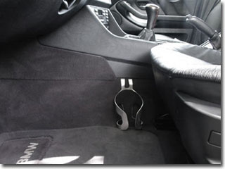

E39 cup holders are the WORST! I ordered a blockoff plate for the factory ones and a set of these:
