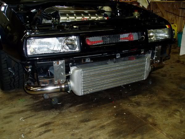

I went with a Precision bar and plate FMIC. They use garrett cores, have cast endtanks, and are a great value for the money. Depending on your hp goals and size constraints, they offer three models.
My front mount, 31x8x3.5, can handle up to 600hp. Runs about $370-390 shipped. The smaller core handles 350hp and runs 240-260 shipped.
