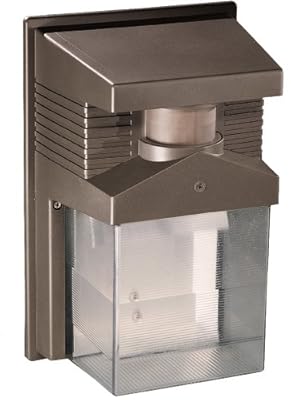

Heath-Zenith DualBrite is your ticket - has both motion and photocell with timer in a single lantern.
^^ That is a pretty cool product, unfortunately the reviews are pretty bad. I think that I may pick one up just to try it out since my switch and light are pretty close.
hmm… which product are you looking at… that appears to be a whole line
I picked the motion detector and the switch: http://www.amazon.com/Heath-Zenith-WC-6053-WH-Motion-DualBrite/dp/B002RT8LJO
those are kind of what I’m looking for… but I want on/off, not high/low. might be the closest thing I’m going to find without going custom
Get a standard motion light and plug into a timer…? Kind of half assed but you can get two good quality products to use.
AFAIK they are on/off when it is just motion and high/low when it is both motion and within the specified “dusk” interval.
