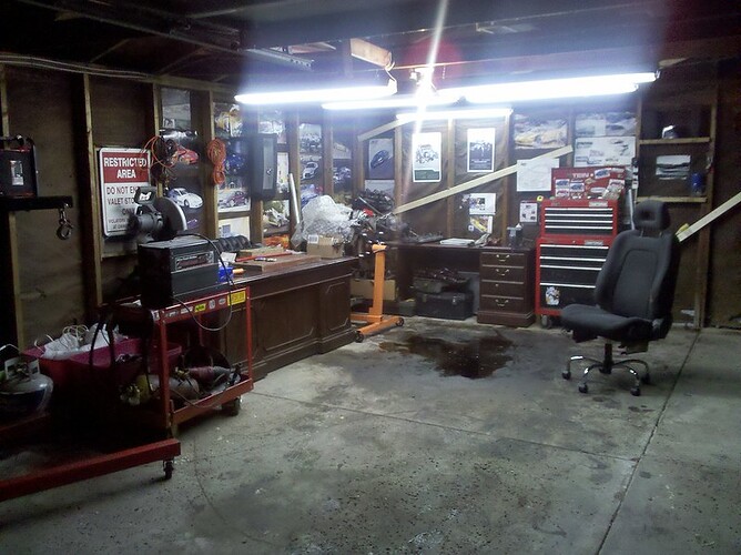

love the chair…got 2 spec v seats myself to make one
