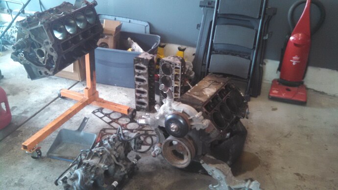

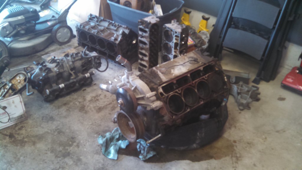

Which brings us to this past weekend. Was cleaning up the garage a bit on Sunday morning, on a whim decided to hop on the local Craigslist and do the usual search for “6.0”. Lo and behold there was one locally for cheap, with a “slight knock”, For my purposes, perfect! It came with some nice parts that will help recoup some costs. Loaded her up and had it home before noon. Not much info on the motor other than that it “came out of a steak truck” (LOL) and had aluminum 317 heads (so, it was at least a 2001+).
Yanked the intake and heads and checked bores, they looked great for unknown mileage.

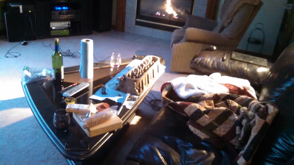

Removed the remaining 15 valve springs at my super fancy cylinder head service bench. Wine and cheese come standard
