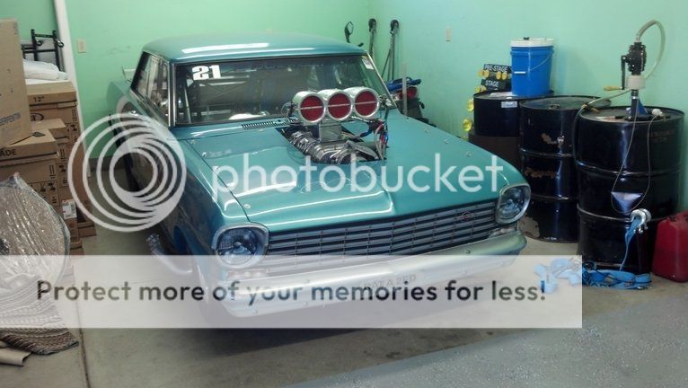

^ No do it like that.
Do it like Larry Larson’s street driven Nova, that does 209Mph in the 1/4.
