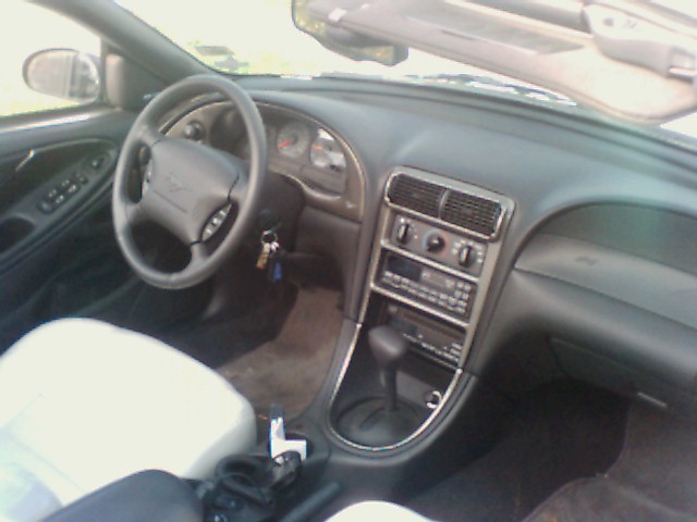

Looks like this right?
http://www.gonzales-family.com/interior.jpg
If so, there are 2 small holes on each side of the radio, this is meant for a special tool that removes the factory deck. Its 2 U-shaped prongs that slide in, you put outward tension on it, and pull the deck back. Pretty straight forward.
i thought he has a aft mkt deck in it
@94gt5.0… yes it looks exactly like that but there is already an aftermarket installed in there therefore I do not see the holes on there to pry it out. I just dont want to break the panel and make it look cracked. The car is clean inside and out.

if you pull of the trim panel around the radio, you will see 2 small openings on each side of the aft. radio (most radios). Insert 2 small screwdrivers to release 2 taps that lock the outer trim cage to the radio itself. Then the radio should just pull out of the sleeve.

Wow. I have no idea what Sully did to the car, but its pretty cool. The panel DOES NOT have to come off. Literally the cdplayer itseld just slips right out.
So I got everything out. Now just looking for a new cd player to put in there :smiley:
Thanks for the help guys. You were all right about the the little locks/clicks. I just used a thin piece of cardboard to unclip them. worked easy
