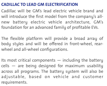

With all that in mind, most manufacturers have oversized their batteries so the consumer won’t observe sizeable battery degradation. The Volt is a good example of this – that pack is huge and underutilized. Tesla seems to do a good job with this too (and they should, their cars are really expensive) – cylindrical cells have great cycle life. My feeling is that as the industry goes toward profitable BEVs that they will have to limit this reserve capacity, and the degradation will be passed on to the consumer.

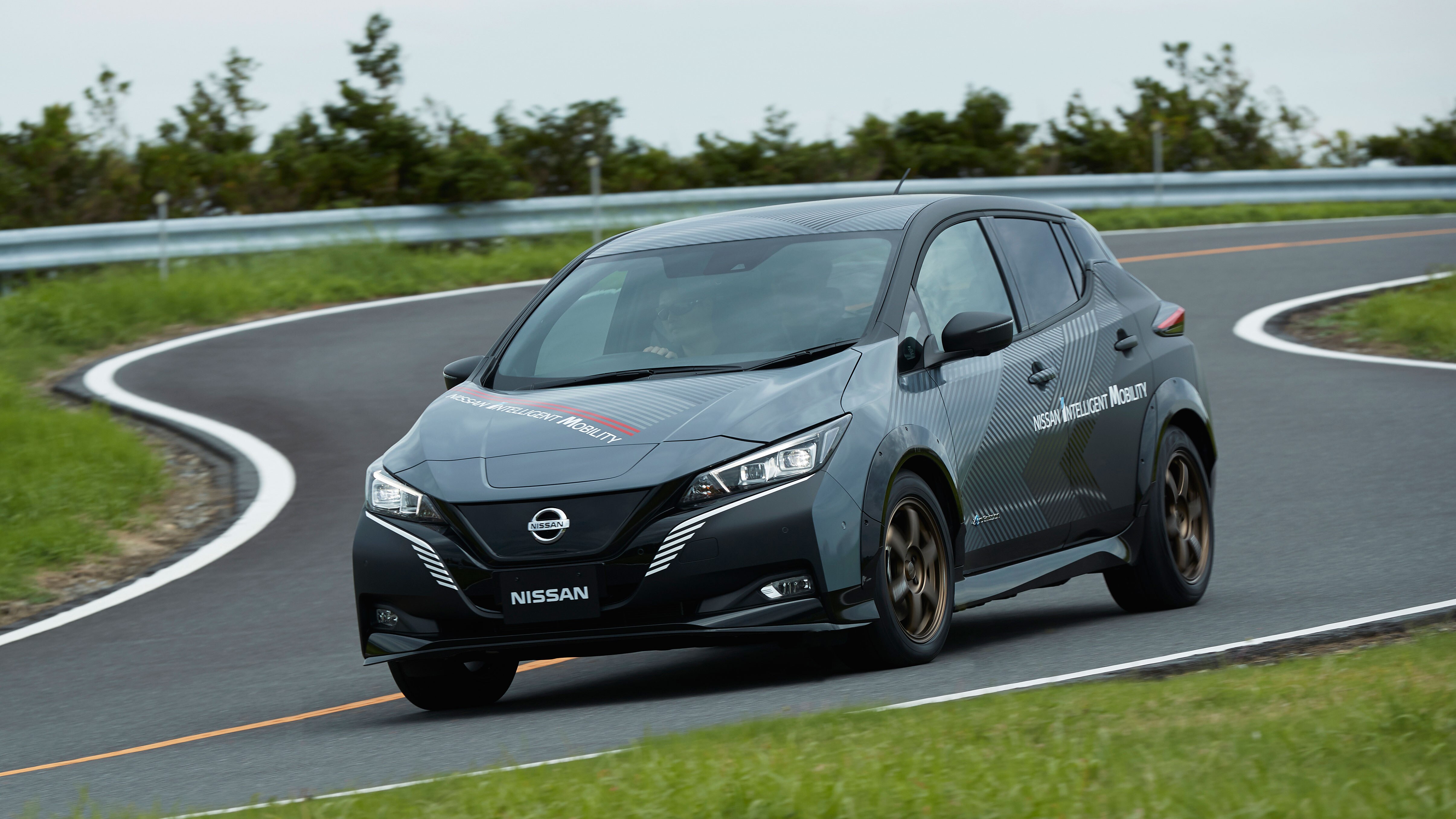

Oh rly?
That’s less power than a Tesla Model 3 Dual Motor Performance, but a good deal more torque.
Just like with ABS, airbags, stability control, iphones etc…in the next 10 years we will all wonder how the hell we lived without awd torque vectoring. With the right spatial awareness and control software stability control could turn into outright accident avoidance.
