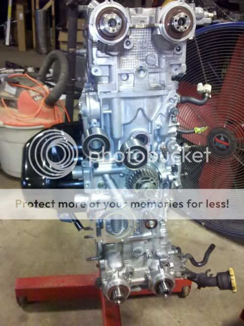

Shiny new shortblock. The AAAB bore worked out PERFECTLY with the pistons I had. I have between .0032 and .0039 PTW clearances on the stock bore due to differences in piston size. One of the bores was quite large (obviously the .0039 PTW)–the rest are all .0032-.0035. Rings are gapped and ready to be installed (minus the piston I cant yet get out). Hopefully im one of the ones that has good luck with stock bore/“drop in” pistons.
http://i16.photobucket.com/albums/b35/johnms88/IMG_20110818_163650.jpg

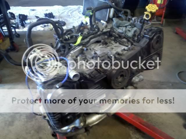

For anyone looking to take off an intake manifold, I suggest you follow the FSM to the letter. There are quite a few hidden plugs and hoses that are hard to see.
2 hours to pull the motor, remove clutch/flywheel, and get it on a stand. Not too shabby for someone who doesnt have a clue what they are doing.
I suggest that you remove the upstream o2 sensor from the manifold prior to pulling the motor out. Its a tight fit and any mistake causes it to make contact with the chassis.
http://i16.photobucket.com/albums/b35/johnms88/IMG_20110820_115515.jpg
http://i16.photobucket.com/albums/b35/johnms88/IMG_20110820_115524.jpg

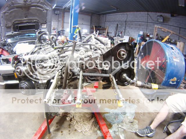

Pretty productive day, minus the cam bolts-- let me tell you those are not fun. I also think im going to pull off the oil pump that I installed today. Im pretty sure I used too much fugibond on it and am worried the excess will make it into the oil.
Got the motor out and stripped. Cams are out. One head is back on the new shortblock and torqued, other head will go on tomorrow. PIX!
Heres our contraption to get the cam bolts out. It involves an old timing belt, 1 c-clamp, 3 vise grips, a 10mm allen socket with 3/8 to 1/2 adapter, a breaker bar, and a pipe. Worked absolutely fantastically minus the one bolt that we stripped due to user error/not paying attention well enough. For anyone who is not familiar with subaru, these bolts are notoriously impossible to remove without damaging them. Subaru has a special tool for holding the cams, and it isnt cheap so this method is needed to get them out. A good impact gun doesnt even touch these bolts.
http://i16.photobucket.com/albums/b35/johnms88/GOPR0162.jpg
Had to copy mikes bolt stress relief method on the one we stripped to get it out. It worked perfectly, because once it was cut, an EZ-out grabbed the shit out of it and zipped it out like butter.
Heres a video of it in action. Excuse my commentary, in the heat of the moment I thought I was the smartest man alive. Looking back, im pretty sure a monkey could have done that.
Here’s a video of impact failing to get the bolts out. That’s a 785 foot pound impact to give you some reference as to how fucking tight these bolts are. I was terrified of those vice grips flying off at my balls. May be NSFW as i do swear once…haha.
