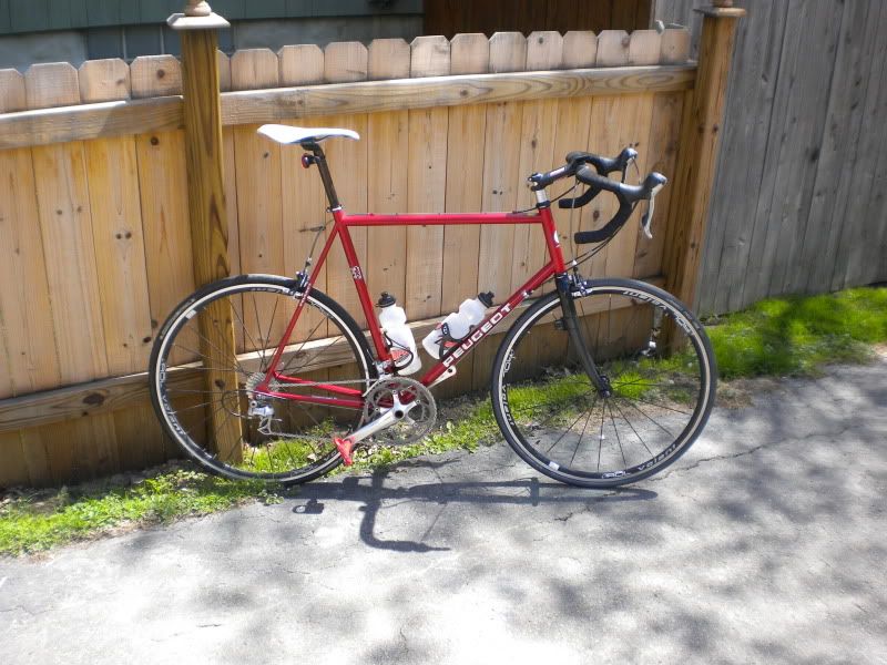

What kind of bike is it? If it has horizontal rear drop outs it will lend itself easier to single/fixed gear configurations. I recently built up a Peugeot frame using my old components and buying some new ones that did not transfer over. I had to buy a 1" threadless fork, which is getting to be hard to find. I ended up getting it through Nashbar.com for $80, it is plain carbon with an aluminum steerer tube. The headset was also a bit of work to buy, it ended up coming in wroong like 3 times but in the end I got it. I had to buy a new crank and bottom bracket, got a pretty nice SRAM for $99 through Ebay. For the front derauiler I had to get a shims as my Dura Ace front was for a thicker tube diameter then the steel frame I was putting it on-Ricks in Buffalo had shims for $7-but if you are goiing SS this is not a concern. I also had to get a smaller diameter seat post, forgot about that. The frame was bought by my dad for 70, he was all poopy pants when it arrived and wasn't lugged steel, so it sat in a box for years until I built it up. So basically it is a 15 year old brand new frame as I was the first person to build the bike. It rides really well and for the small amount of I have into it I couldn’t have bought anything close to it in terms of quality. Of course it doesn’t exploded up climbs like carbon but steel has a seemless ride and I can hit 50+ downhill and it is rock solid where my carbon bike will get twichy. Here it is all assembled
Did it come with the dura ace groupset? If so that’s baller as hell
richard i am impressed at how deep you have gotten into the bike game…
