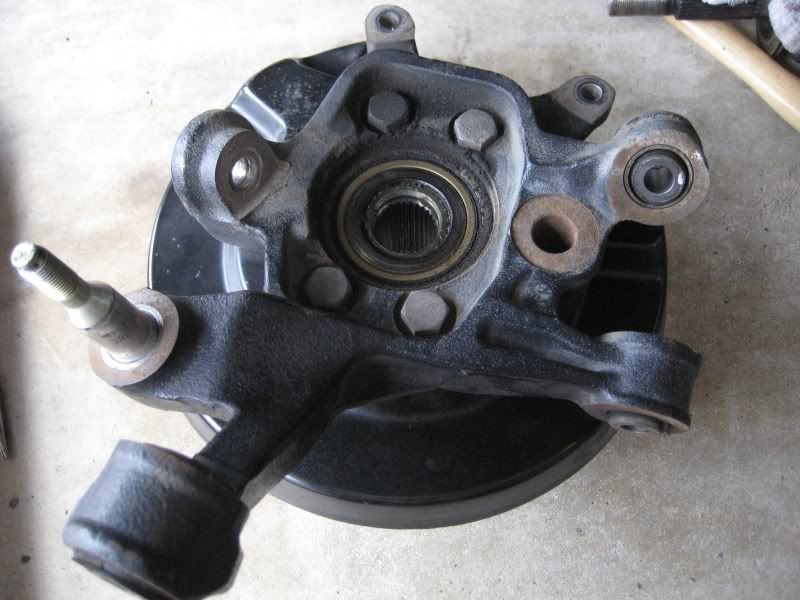

there are stock rubber bushings in the spindle where you will be bolting the outer part of the multilinks to. you can see them here:
ideally you would use 2x4’s like you said but usually 240s are lowered and you wouldnt be able to get at the upper ones. so use a pump jack to compress the suspension, tighten the bolts, let jack down, then put the wheels on and lower the car.

yeah I am referring to the rubber bushings that mount the sub frame to the car itself, your after market suspension should come with rodends/ heim joints and spacers at least mine did. I have the whole sub frame off my second car right now if you want to come have a look and see what your in for. I’m getting ready to install the whole god speed aftermarket setup including control arms and the vlsd off my se :smiley:
