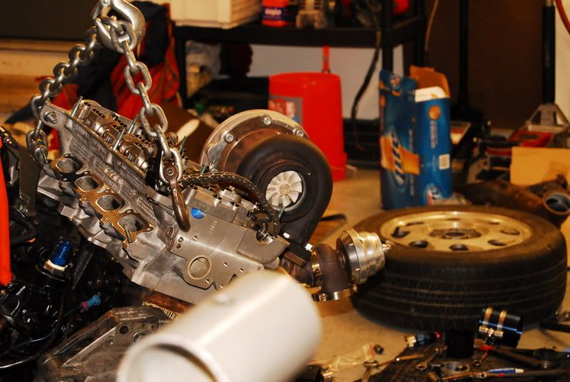

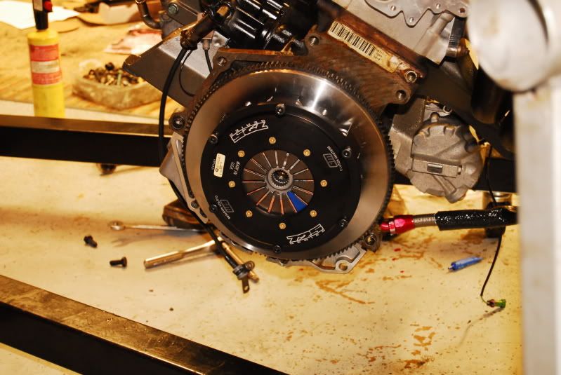

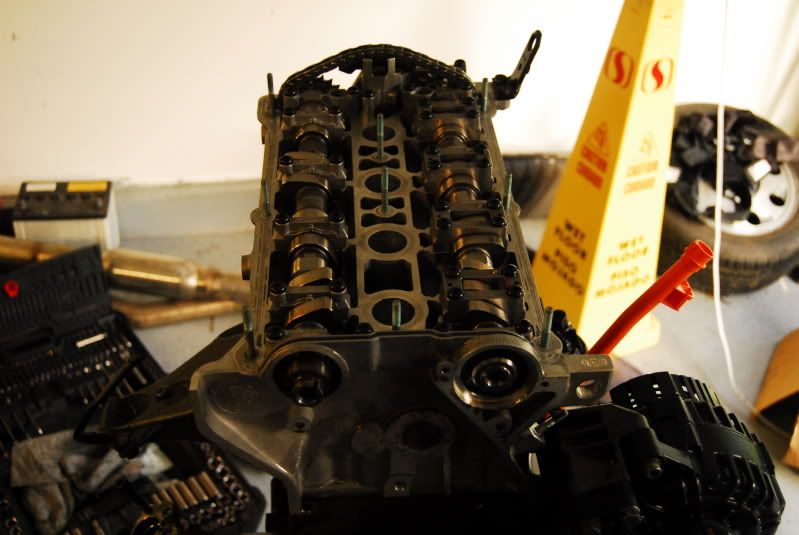

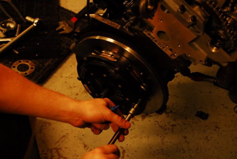

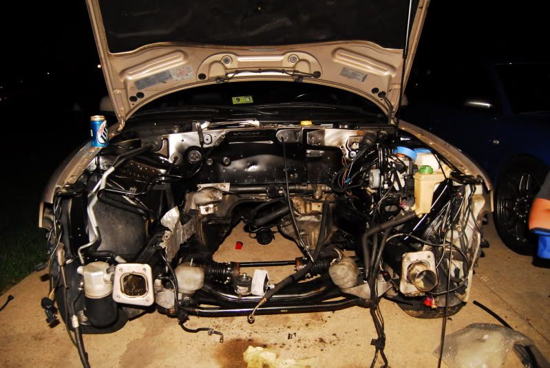

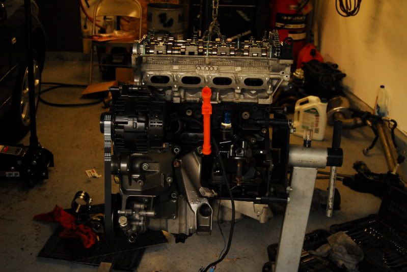

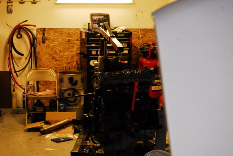

Bubba came over with his fancy camera today and we did some work. Engine goes in and hopefully start tomorrow. Don’t see anything holding us back at this point.
:slight_smile:
More tomorrow.

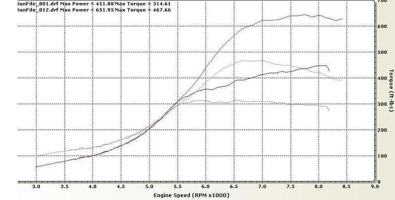

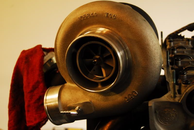

What do you plan on revving this to?
I’d really like to see the power curve when this is all done as well.
8500 is the limiter. This is the power curve from the last motor w/the same turbo.

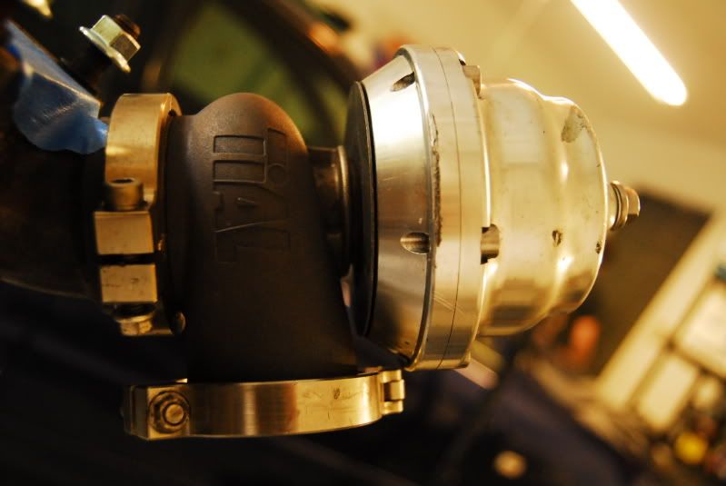

18.5psi pump, and 35psi c16.

There is only two problems… It’s missing a cylinder, and has one too many valves per cylinder…Seriously. Stuff an AAN or 3B into that thing, the REAL 20VT. No, I’m just kidding. Keep up the good work!

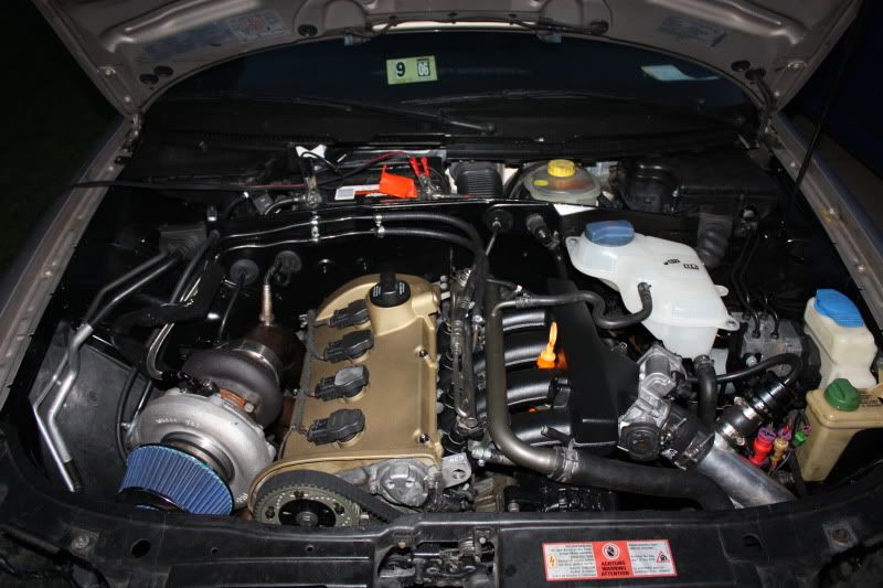

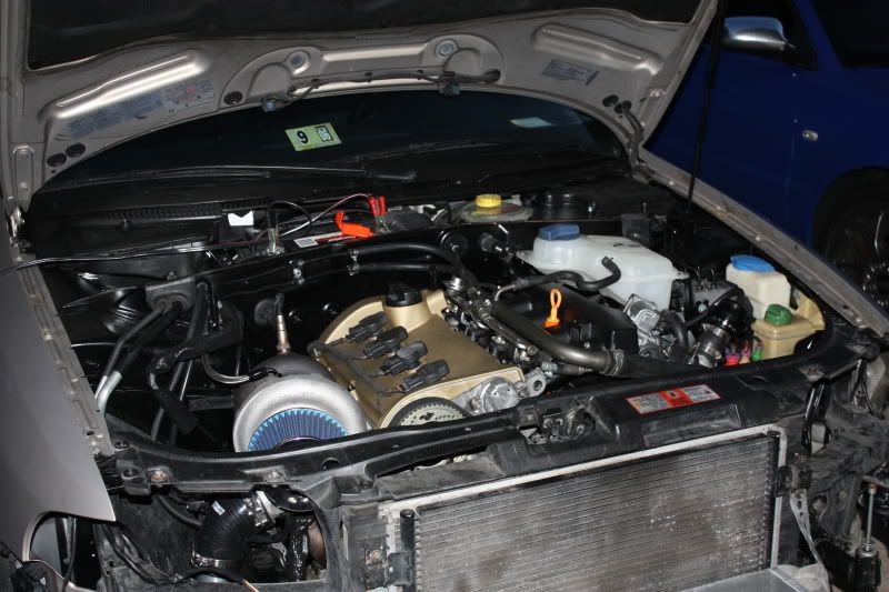

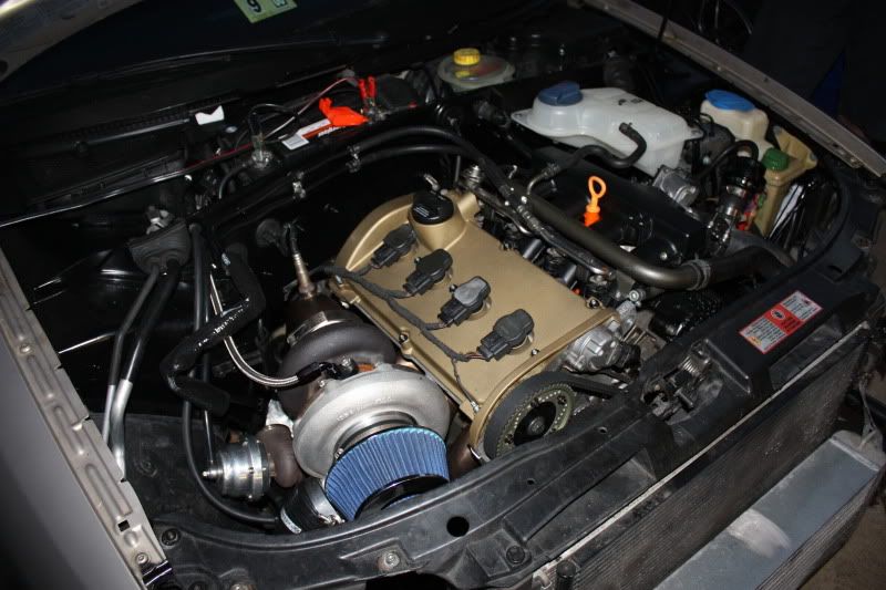

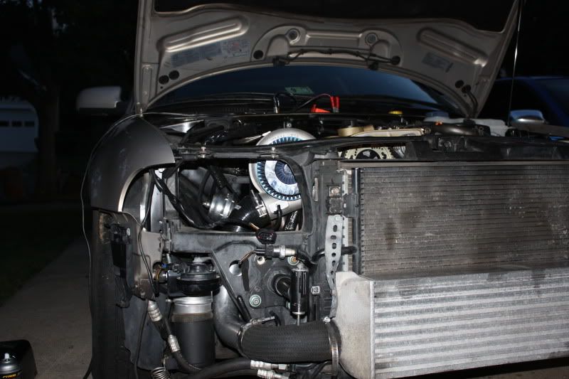

She Runs. IC Piping and Exhaust need to be re-done. I need an OBD1 throttle body… but other than that, we’re good to go :slight_smile:
