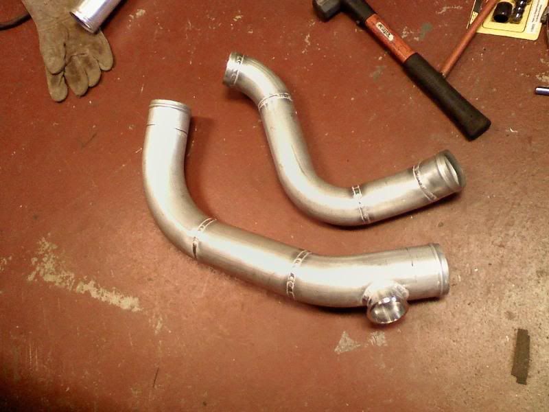

Got all the new IC piping all fabbed up to replace whatever you call it that was on there.
Old:
New:

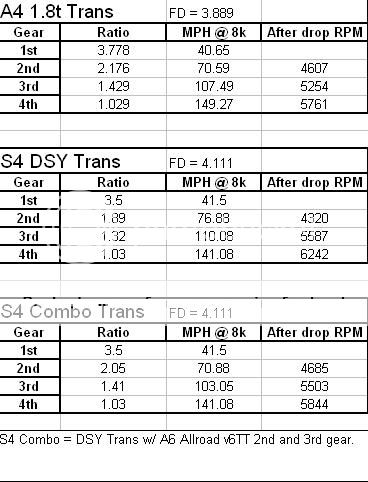

it’s not bad, the shifting isn’t nearly what everyone was bitching about. Mine’s much better than my rommate’s s4 though. perhaps because I stuck to the 01a shifter stick and just used the rest of the s4 guts for the rest of the shifter.
Looking for some new ratios though… can use a6 allroad gears, but the 3-4 shift is still slightly a killer. let me know if you know of anything that would be swappable into it.
