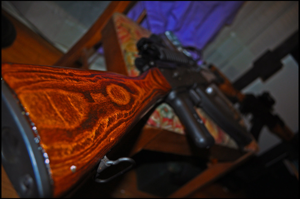

I just picked up another Romanian WASR-10/ AK-47 variant. At $499, with 2 mags, I just might buy myself another one of these. I’m finishing the furniture on one of them now. Once I get it back together I’ll post some pics
Very nice. That’s one thing id change if I end up keeping mine. Wood stock.
Thanks. I prefer the wood. I like the classic look to the rifle. The only thing I don’t care for, is the cheap pistol grips, that are put on them. Here’s a close up of the stock, which I just finished:
