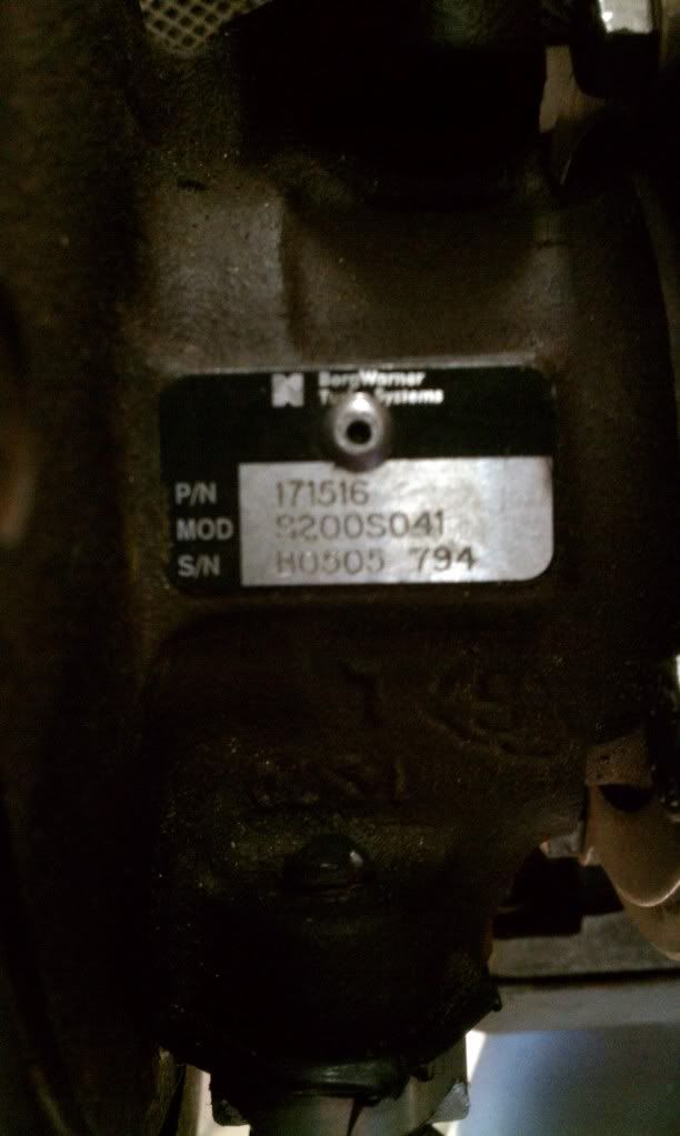

Can anyone tell me what turbo this is? like dimensions and all that. buddy of mine got it with a built motor and have no idea what it is
http://i220.photobucket.com/albums/dd251/gooseleegt/turbo.jpg
http://i220.photobucket.com/albums/dd251/gooseleegt/tuurbo.jpg

its an s200
According to this, it’s a John Deere turbo…? http://www.turbo-baltija.com/assets/files/vendors/borgWarner.html
hit ctrl+f and search on s200s041
this guy says the same thing, T4 flanged http://www.cumminsforum.com/forum/94-98-performance-parts-discussion/364653-turbo-help.html
s200 and 300 are common place on john deere and other diesel equipment. It was Borg Warners way of trying to flash up something they already had so they could compete with Garrett and not have to do any sort of new development. On that note they make huge boost for a single stage but Garrett > *

turbo diesels have pretty decent turbos, this one looks solid for what it is
