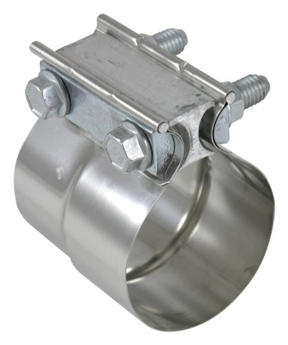

So I finished installing the exhaust system, spent a good amount of time aligning the tips as I wanted to do it right and do it once. I did replace the band clamps that came with the XS Power system with some better quality, stepped 3" band clamps. They are holding perfect.

http://www.amazon.com/Torca-TorcTite-Preformed-Exhaust-Stainless/dp/B002VR756C/ref=sr_1_sc_1?ie=UTF8&qid=1460560357&sr=8-1-spell&keywords=torc+tite
Initial impressions - the cutouts do a great job of sealing the exhaust noise when closed. I laid underneath the car while it warmed up for a good 10 minutes, feeling with my hand for any leaks or telltale “puffing” in and around the valve itself. Nothing at all. @cougarspeed did a great job welding it all up. I think the v-bands warped ever so slightly but I blame this on the lack of a protruding flange on the machined ring itself…not a big deal. There was the occasional drop of condensation that came out of the closed butterfly, but this is to be expected and went away as the system warmed up and expanded.
