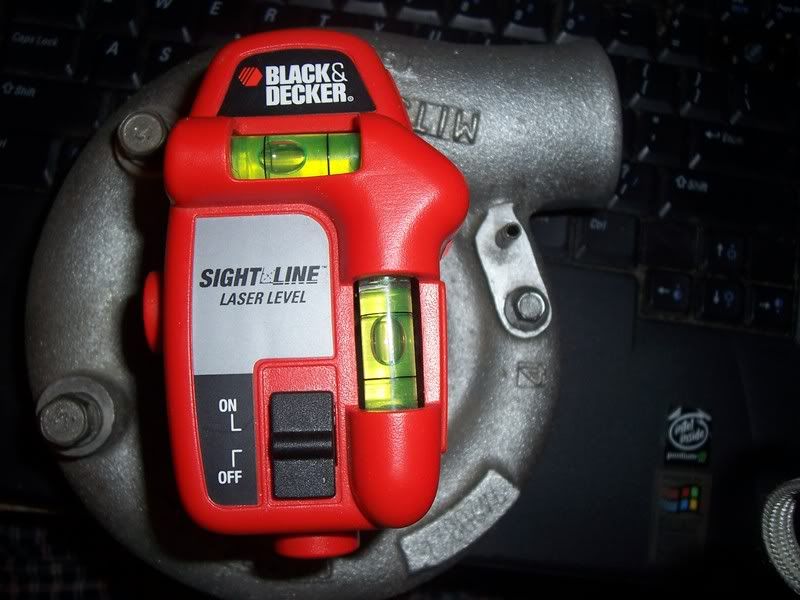

12:14 MidShipCivic: your driveshaft alignment with the laser leveler
12:15 sprocketbash411: yeah…
12:16 MidShipCivic: how long did it take you to get it perfect ?
12:17 MidShipCivic: did you even use the leveling part ?
12:17 MidShipCivic: http://img.photobucket.com/albums/v169/C-Zero/FMS13/Picture.jpg
12:17 MidShipCivic: I was going to place this in the flat part of my valley to get something worked out
12:17 MidShipCivic: http://img.photobucket.com/albums/v169/C-Zero/FMS13/Picture174.jpg
12:17 sprocketbash411: the level part doesn’t matter
12:18 sprocketbash411: just the direction
12:18 sprocketbash411: also, go off of the rear of the crank
12:18 MidShipCivic: I see
12:19 sprocketbash411: you do not know that that flat part is constrained to the driveline
