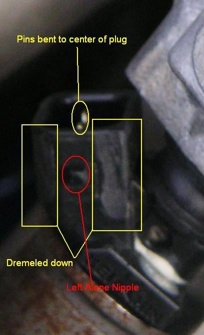

Just bought 450 dsm injectors now I need the harness for the injectors to the resistor box.
just take the stock civic injector plugs and break the little tab on the inside that keeps them from being plugged in
+1, stock harness will work fine…didnt i tell you this matt?
Heres a write up to help you understand it a little better…
