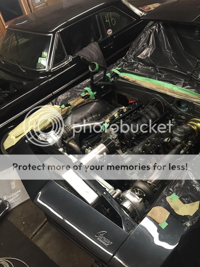

Made the cold side yesterday. Everything id done on the coldside aside from welding in 2x BOV and an IAT bung.
welded vbands on the other sides of the downpipes sorry forgot pics! Need to make a transition to the exhaust.
Soon it will be time for many many many AN lines/fittings.

So this thing is moving along.
Old body bushings. Replaced with Energy Suspension kit
Made a blockoff plate and welded up the water pump heater holes. Usually loop these. Have read mixed stories on if you should block em off…One way to find out.
Decided to keep the slip on style exhaust. Makes fitup easy as pie. Made the pipes from the downpipes to the 2.5" exhaust last night. Didn’t install them yet after I finish welded them though.
Props to the guys at Mufflerman for hooking me up with this 3" to 2.5" slip fit transition.
Done!
This is what 3AM welds look like after a few too many adult beverages. Overall I will take it haha.

Started the fuel system yesterday, new wastegates tomorrow hopefully, lots of AN lines in my future. I will swap fuel tanks(sumped) either tonight or tomorrow maybe. The list is getting shorter!
