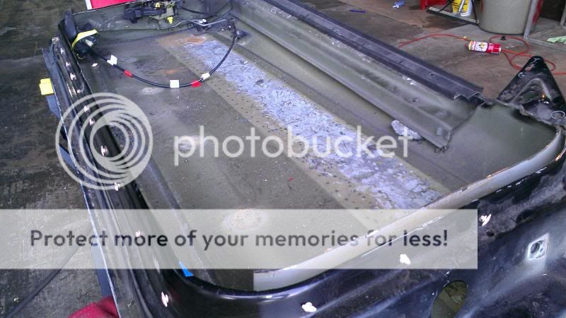

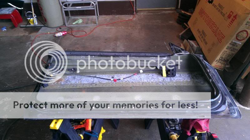

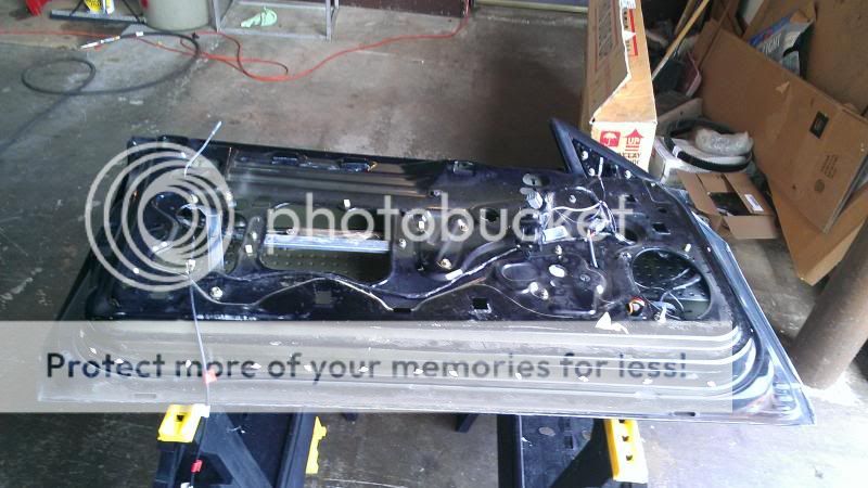

started gutting the driver door today. probably took 1/2 the weight off from what it started at even without the glass. going to weigh before/after today when i go over there.
http://i4.photobucket.com/albums/y133/naaby2687/Black%20Mustang/IMAG4400_zps10fa3b87.jpg
drilled out the spot welds for the crash bar in the door since ill have door bars on the cage
http://i4.photobucket.com/albums/y133/naaby2687/Black%20Mustang/IMAG4405_zps2b3ea2c7.jpg
http://i4.photobucket.com/albums/y133/naaby2687/Black%20Mustang/IMAG4404_zps492b1883.jpg

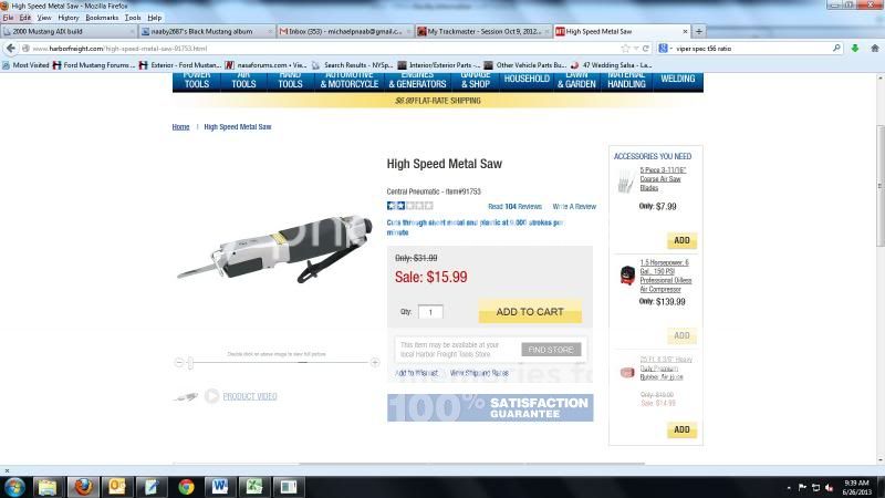

bought one of these for $15 bucks. the blade was toast after doing the whole door but it worked flawlessly. easy to get a nice straight cut too!
http://i4.photobucket.com/albums/y133/naaby2687/Black%20Mustang/metalsaw_zps9591ddf0.jpg
and ended up with this. i think it came out pretty good. have to trim some of the other bracket material that was underneath the door skin but other than that its good to go.
http://i4.photobucket.com/albums/y133/naaby2687/Black%20Mustang/IMAG4403_zps2374d99c.jpg

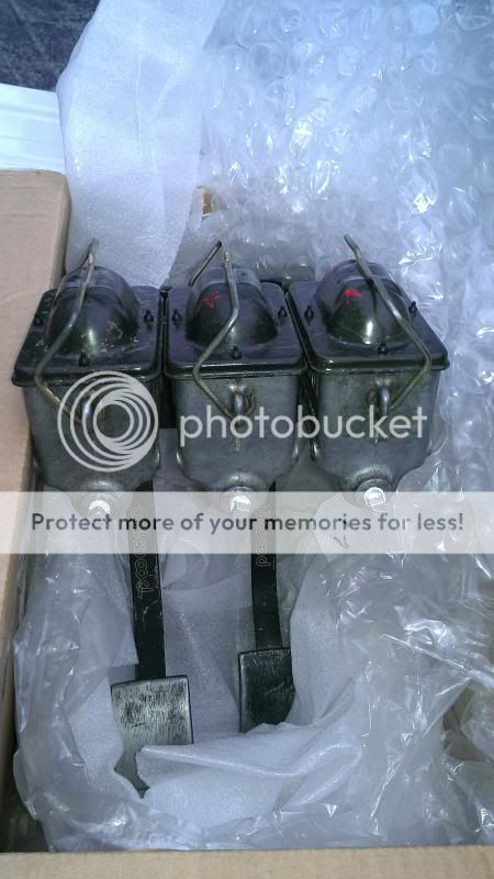

and some parts came in within the past few days

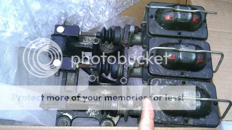

wilwood pedals- with wilwood masters and brake bias adjuster
http://i4.photobucket.com/albums/y133/naaby2687/Black%20Mustang/IMAG4417_zps0995b504.jpg
http://i4.photobucket.com/albums/y133/naaby2687/Black%20Mustang/IMAG4416_zpsd8bd7caf.jpg

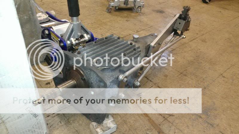

Jerico Tranny
http://i4.photobucket.com/albums/y133/naaby2687/Black%20Mustang/IMAG4399_zps1d1333fb.jpg

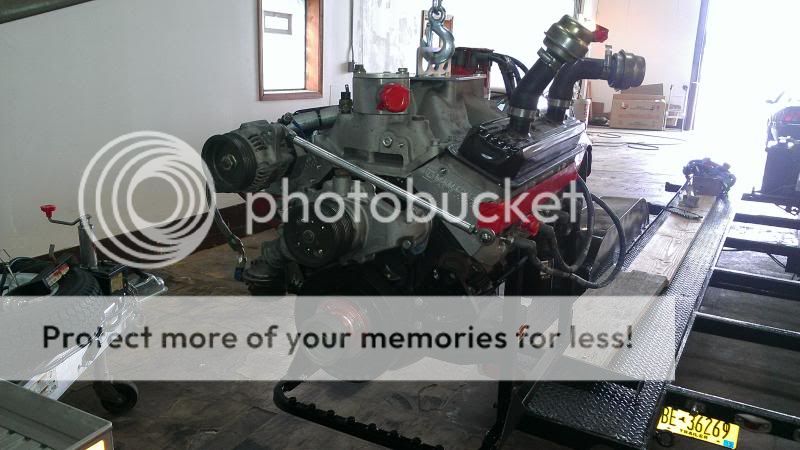

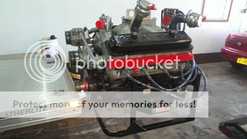

and a couple pics of the motor on the hoist
http://i4.photobucket.com/albums/y133/naaby2687/Black%20Mustang/IMAG4397_zps88b24127.jpg
http://i4.photobucket.com/albums/y133/naaby2687/Black%20Mustang/IMAG4396_zpsc198fab2.jpg

tilton pedal setup. much more baller than the wilwood lol
http://i4.photobucket.com/albums/y133/naaby2687/Black%20Mustang/IMG954170_zpse1a42a35.jpg
Used Jerico RCR tranny with REM polished gears. pretty much decked out.
ratios are 2.94/1.91/1.33/1.00
http://i4.photobucket.com/albums/y133/naaby2687/Black%20Mustang/Jerico1_zpsd190caa4.jpg
so ill probably sell the wilwood pedals and the other tranny. should be able to make a few bucks on the tranny with the deal i got on it

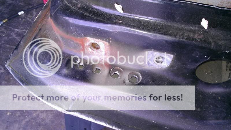

wanted to smooth out the engine bay a little and get rid of the 1462347234 holes that were in there. so i bought some POR-15 Epoxy (this stuff http://www.por15.com/EPOXY-PUTTY_p_54.html)
prepped the holes with a little sanding and applied the epoxy
http://i4.photobucket.com/albums/y133/naaby2687/Black%20Mustang/IMAG2723_zps45356643.jpg
then i ground it smooth a day later with a flap disc. way to heard to sand by hand. came out pretty good. wont really need much of a finishing smooth at all.
