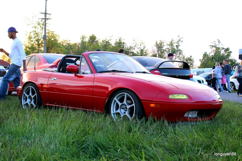

94 R-package miata

Looks like a lot of fun. Not feeling the bright red seats though.
Is this car your daily or just for fun? How much weight can you save removing the top entirely? I want a miata pretty bad, just have no place to keep it.
The seats are currently replaced with black Bride Vios III Lowmax which is why the sparco’s are for sale :slight_smile:
The car is my summer daily/ auto-x/ track day slut. I have a dedicated set of r-comps for race days. The top is about 20 or so lbs. I am keeping my top only because I like the top down in the summer.
