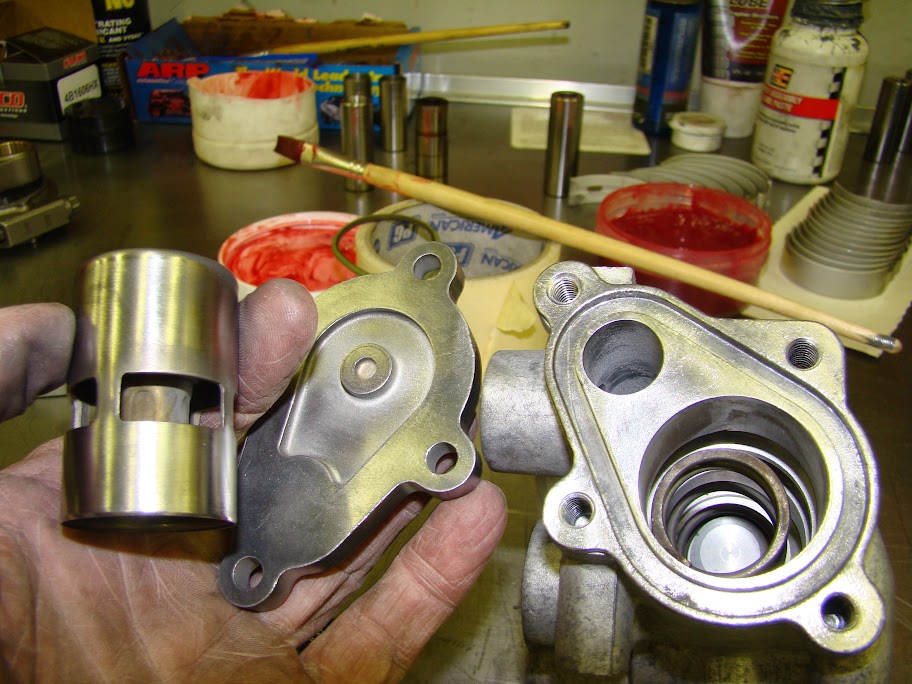

Oil pump ported and rebuilt:
Oil thermostats cleaned up and rebuilt (mine was bad!):
Line hone:
Honing:
