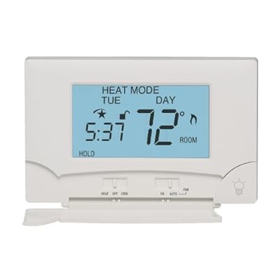

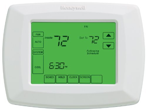

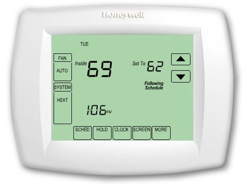

Here is the one I bought. It’s rated very high with consumer reports and works well. You can program 4 different times, and all of the days. Has a nice feature to show the use of the filter as well.
I have one of these in my house and LOVE it. so easy to set, can set individual days or multiple (non-consecutive) days. You can also set the hold time if you want to bump it up for a bit. They offer this one with 1 heat/1 cool, 2 heat/ 1 cool. 2 heat/2 cool and 3 heat/2 cool configurations. I have a 2h/1c at my home (I think.) I am fairly certain my parents have the same one and they like it a lot as well. mine also has the Exterior temp displayed on it as well.
